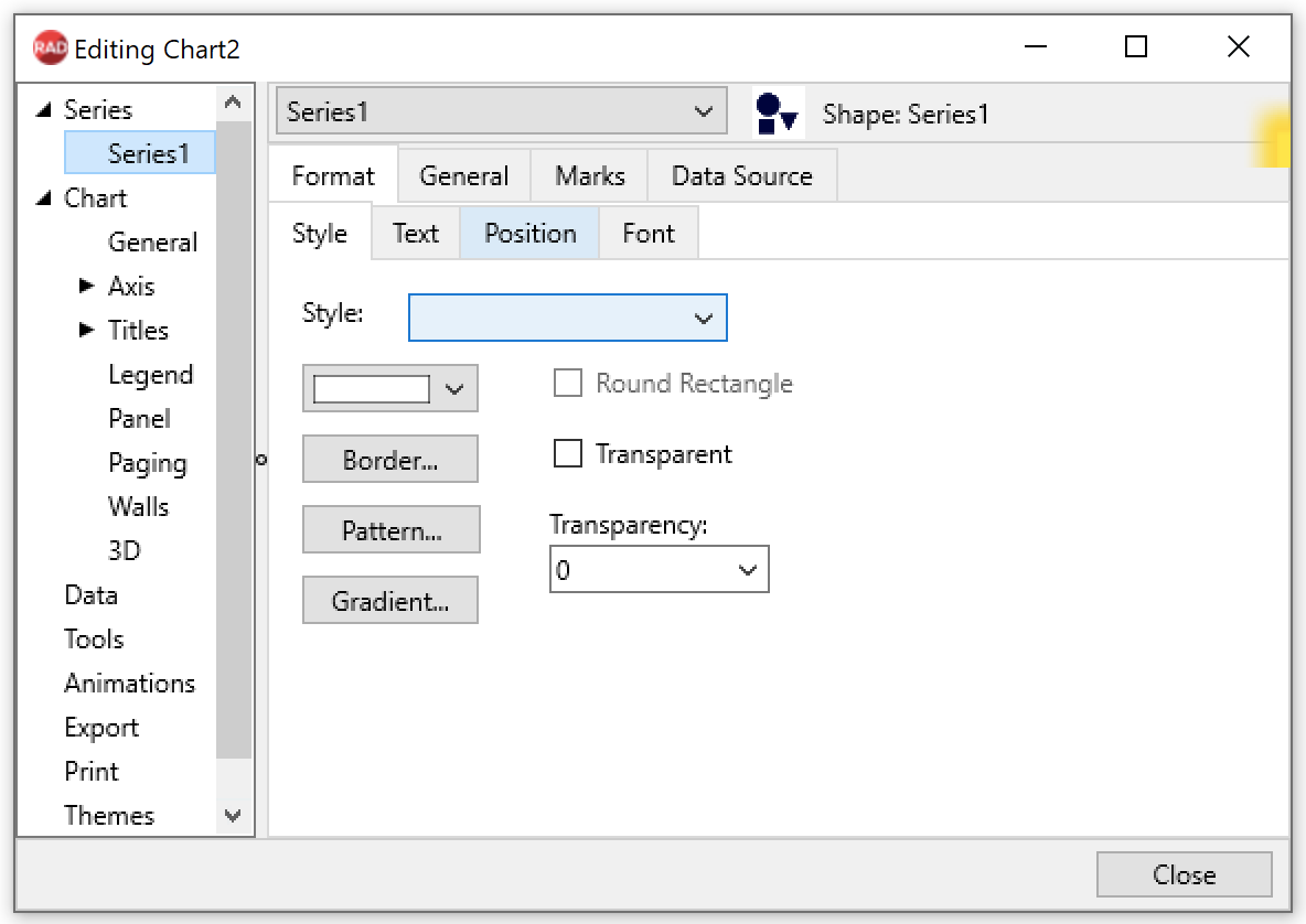

When adding a Shape Series, you cannot select a Style, or Text alignment, or the units.
In the FMXTee.Editor.Series.Shape the Combo boxes are empty, and the RadioGroup things were not ported to FMX.
At least the new FMX - TRadiogroup was not filled with items using the Add function.

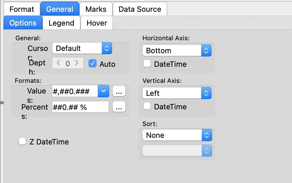

In OSX some of the labels are broken, wrapped, or cut off because of formatting in the individual FMXTee.Editor.xyz files
Example:
Screenshot 2021-11-16 at 18.09.14.png (272.31 KiB) Viewed 44765 times
This issue spreads over a few different Editor tabs.
I've seen that so I've added to the public tracker at #2486. And I've corrected it.
I've added it to the public tracker at #2487.
