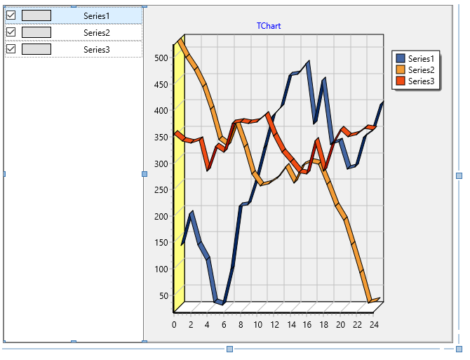

1. Changing the checkboxes in TChartListBox has no affect on the Series being displayed in the TChart. The image below shows the FMX version with all three series unchecked, but they still show in the chart. The VCL version shows Series1 unchecked and it doesn't appear in the chart.
2. There is a long gray column to the left of the checkboxes in the FMX ChartListBox. My assumption is this has to do with the Icon property of the list box not being shown correctly. See in the FMX version of the image above.

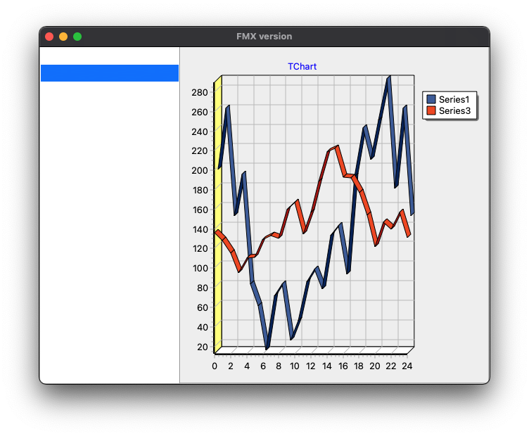

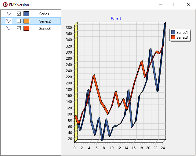

The ChartListBox is still blank on Mac, Android and IOS. The first image below shows the program running on a Windows 10 machine. The second one shows the same program running on my Mac Mini. In both programs, I have selected Series 2 to hide that series in the chart. As you can see, ChartListBox on the Mac appears to contain the three Series ListBoxItems, with the Series2 ListBoxItem selected. And I can show and hide Series2 in the chart by pressing that line repeatedly on the Mac. However, the ListBoxItems on the Mac are blank.
My assumption is this same problem occurs on the Android and IOS devices, but the ListBoxItem lines do not get highlighted on those devices, so I am not sure.
FYI: I used the original source files from the 35 zip file I got from your site, replaced the FMXTee.Chart.ListBox.pas file with the latest one you sent me and then used TeeRecompile.exe to rebuild the source files, so everything should be up to date on my system where Teecharts is concerned.
