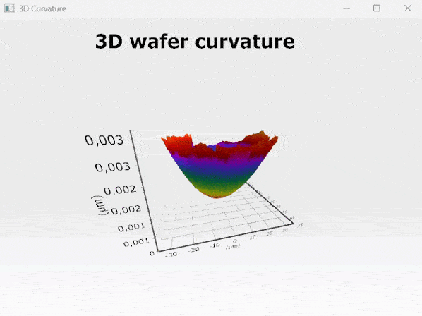

To demonstrate the performance I'm looking for, please find attached a project based on VCLTee I have assembled :
I believe FMXTee's Chart3D holds the answer to my question. It does seem to support hardware acceleration out of the box.
Unfortunately, within a Chart3D, trisurfaces don't render at all on my machine.
In the attachments, you'll find another project to illustrate this, here is its output on my machine :
Any idea what I might be missing ?
