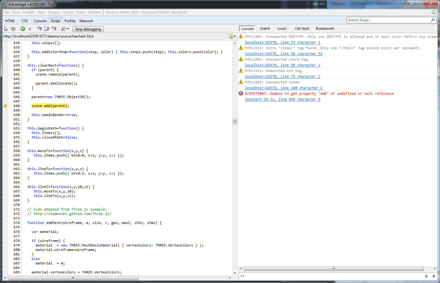

more info on the IE issue. Here is the error no that I have the source code.
Re: new to steema need help with 3dcharts
Post by Yeray » Mon Aug 26, 2013 11:45 am
sct wrote:I'm not having luck with the setEnabled. I tried to put it in various places and either I get a ghost 3d map or d.parentElement is null. This is how I currently do my 2d 3d switching. How would you recommend I do the setEnabled?
Note you have to add the helvetiker_regular.typeface.js and three.min.js scripts besides to the teechart-3d.js to make it run.
