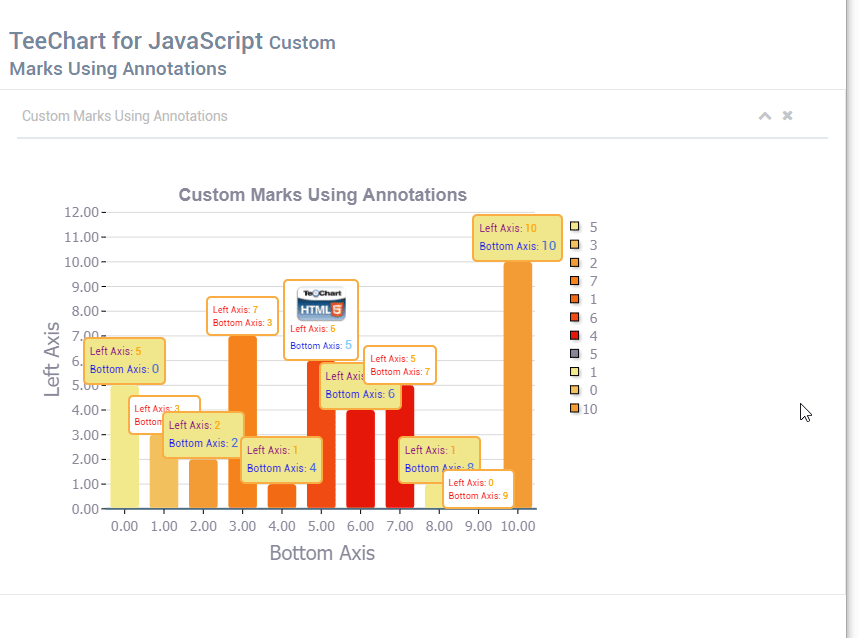

Hi, my ultimate goal is to be able to watermark my chart with a logo in the corner such that when users download the image the logo should appear. I've attempted to achieve this through annotations with the isDom approach referred in the annotation demos
However using the isDom approach causes two problems:
1) Right-click to save as image does not save the logo
2) When I re-adjust the chart, all previous instances of the Annotation box still appears such that if I incrementally adjust my chart horizontally 10 times there will be 10 logos produced overlapping each other. I am certain it is the isDom approach causing this issue as annotations without isDom are working fine.

NickH wrote:However using the isDom approach causes two problems:
The example here uses this approach and I can save the image with a right-click.
In that same example, the chart is resized when you resize the window to a smaller size than the chart. When this happens, the marks aren't repositioned until you move the mouse over the chart, but you can solve it calling changeMarkAnotationsPos() at the end of the resize() function.
