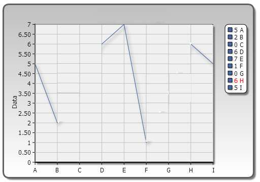

no break line

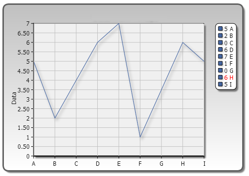

How to set a break line in point B to point D & point F to point H like this

Post by Yeray » Thu Jan 17, 2013 8:43 am
We've added a new treatNulls property to the Line series so with the next maintenance release you'll be able to do this:
Chart1.series.items[0].treatNulls = "skip";   // default is:  "dontPaint"
