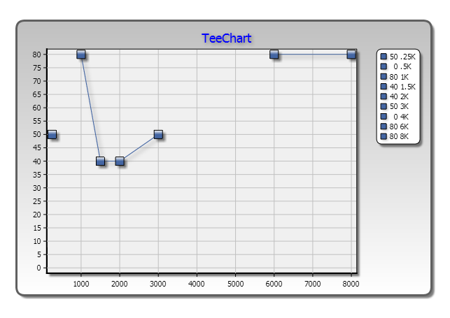

Re: Series Line skip and label questions
Post by Yeray » Wed Apr 17, 2013 1:19 pm
This is what I get with the code below and the actual sources we have here, isn't it what you are expecting?
If not, please, try to describe what are you expecting to achieve, or show it to us in a picture.
  var SerR=new Tee.Line();
  R1=50, R2=null, R3=80, R4=40, R5=40, R6=50, R7=null, R8=80, R9=80 ;
  SerR.data.values.clear;
  SerR.data.x = [250, 500, 1000, 1500, 2000, 3000, 4000, 6000, 8000];
  SerR.data.values = [R1, R2, R3, R4, R5, R6, R7, R8, R9];
  SerR.data.labels = [".25K", ".5K", "1K", "1.5K", "2K", "3K", "4K", "6K", "8K"];
  Chart1.addSeries(SerR).pointer.visible = true;
  Chart1.axes.bottom.increment = 1000;
  Chart1.axes.bottom.labels.labelStyle = "value";

Post by DALC.SENIOR » Wed Apr 17, 2013 1:57 pm
Yes, those are the points. The problem is that it is the points that need to be equal distance apart, not the numbers.
_____ .25K_____.5K_____ 1K _____ 2K _____ 4K _____ 8K are spaced equally on the x-axis.
Post by Yeray » Thu Apr 18, 2013 9:26 am
DALC.SENIOR wrote:Yes, those are the points. The problem is that it is the points that need to be equal distance apart, not the numbers.
In that case, you should add the points in equidistant data.x values and show the non-equidistant values, your series labels:
  Chart1=new Tee.Chart("canvas1");
  Chart1.draw();
