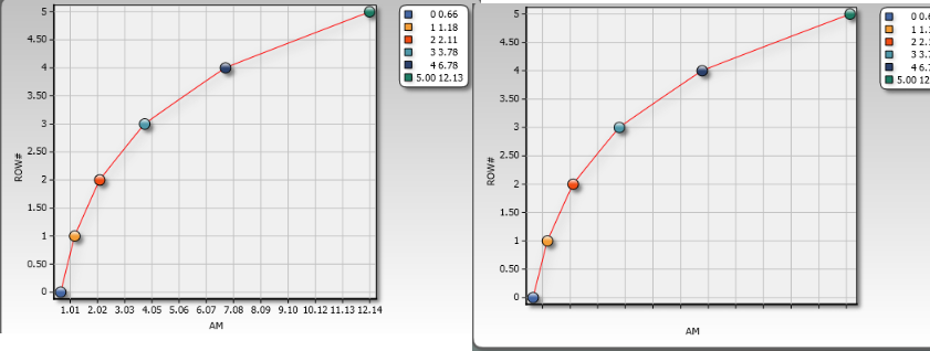

if the X of the chart size is too big the bottom row labels go away? some charts don't do this. In this image I found the thresh hold for this bug. On the left the size allows the graph, on the left I scaled the width just by a few pixels and the label vanished.

Could you please share the code you used to generate that chart so we can reproduce the problem here?

Good chart
this.canvas.width = 400
this.Xdata = 0.66,1.18,2.11,3.78,6.78,12.13
this.Ydata = 0,1,2,3,4,4.99999
Bad chart
this.canvas.width = 700

I've been able to reproduce the problem with the example attached so I've added it to the defect list to be revised for further releases (TF77016700).
The bottom axis labels seem to be correctly drawn with a chart width 500, but with 600.
Thanks for reporting it.
