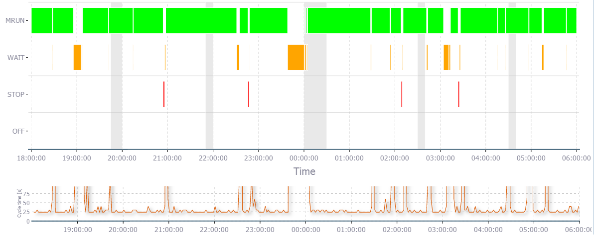

I use Gantt chart to show CNC machine status monitoring.
Time window is one day or 12 hours so I have two shifts to draw (6:00-18:00,18:00-6:00).
Each shift has its breaks with specific length in specific time.
Is it possible to set my own axes.bottom begin, end and step?
For example from 6:00 to 18:00 step 1 hour so axes.bottom labels will be something like "6:00,7:00,8:00,...,17:00,18:00" and grid will accept given labels.
If I will zoom it should change from my axis to auto.
Is it also possible to highlight breaks in shift? Something like colored rectangle under the status bars?
CNC status monitoring example

roman
Posts: 3
Joined: Thu Oct 16, 2014 12:00 am
Re: Gantt chart customization
Post by roman » Thu Nov 06, 2014 8:06 am

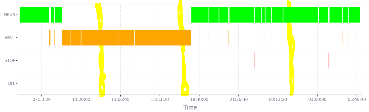

Thank you for you ideas, I solved axis label step problem by defining
var OneHour = (new Date(2014,1,2,6,0,0) - new Date(2014,1,1,6,0,0))/24;
and setting increment to defined OneHour
Chart1.axes.bottom.increment = OneHour;
When I zoom I reset increment to auto and vice-versa
Chart1.onzoom = function(){
        Chart1.axes.bottom.increment = 0;
Chart1.zoom.onreset = function(){
It works very well so case is solved.
As for drawing breaks on canvas under series, I have some problems.
First of all there is no onbeforedraw functionality definition in my teechart.js v1.7 July 2014, I have found only one mention
if (s.onbeforedraw) s.onbeforedraw(s);
Second, if I understand it well, I have to recalculate and redraw everything I drew, related to bottom axis, during every zoom and zoom.onreset.
To do it well I need to calculate
	var x1 = Chart1.axes.bottom.calc(new Date(y,m,d,h,i,s));
	var x2 = Chart1.axes.bottom.calc(new Date(y,m,d,h,i,s));
and draw new rectangles.
What about canvas.clearRect(), is it done during Chart.draw()?
