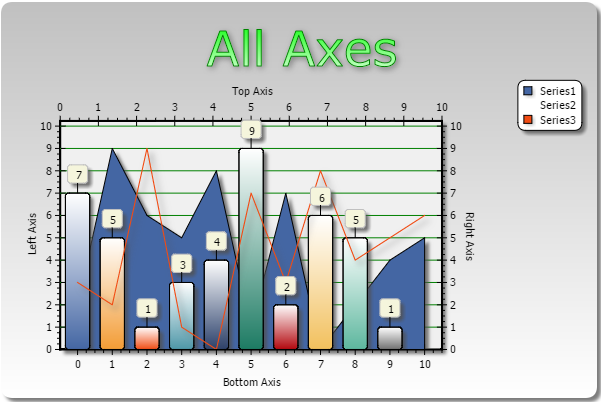

How does one change the color of the lines of the major grid on an axis?
setting "axis.grid.format.fill" affects the banding - quite neat!
setting "axis.grid.format.stroke.fill='#000000'" doesn't seem to work!
I'm trying to make them black!
Kind regards
Mark

Re: Axis Grid Line Color
Post by Yeray » Mon Jul 06, 2015 9:50 am
Hi Mark,
If you look at Axes example here, you can see how to activate/deactivate the grids of all the axes:
function setGrids(value) {
  Chart1.axes.left.grid.visible=value;
  Chart1.axes.top.grid.visible=value;
  Chart1.axes.right.grid.visible=value;
  Chart1.axes.bottom.grid.visible=value;
<input type="checkbox" id="grids" onclick="setGrids(this.checked); Chart1.draw();" checked>Grids<br/>
To see the axis grid color clearly, I've hidden the grid of all the axes except for one. Then, I've added this to the draw() function in that example before Chart1.draw():
  Chart1.axes.left.grid.format.stroke.fill="black";
  Chart1.axes.top.grid.visible=false;
  Chart1.axes.right.grid.visible=false;
  Chart1.axes.bottom.grid.visible=false;
Or on "green":
  Chart1.axes.left.grid.format.stroke.fill="green";
