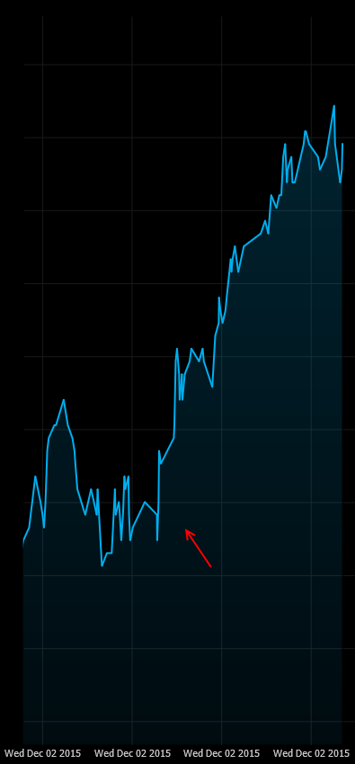

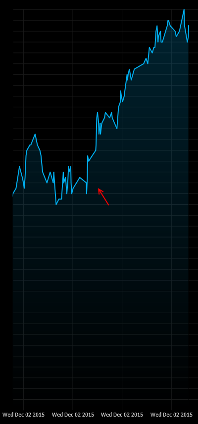

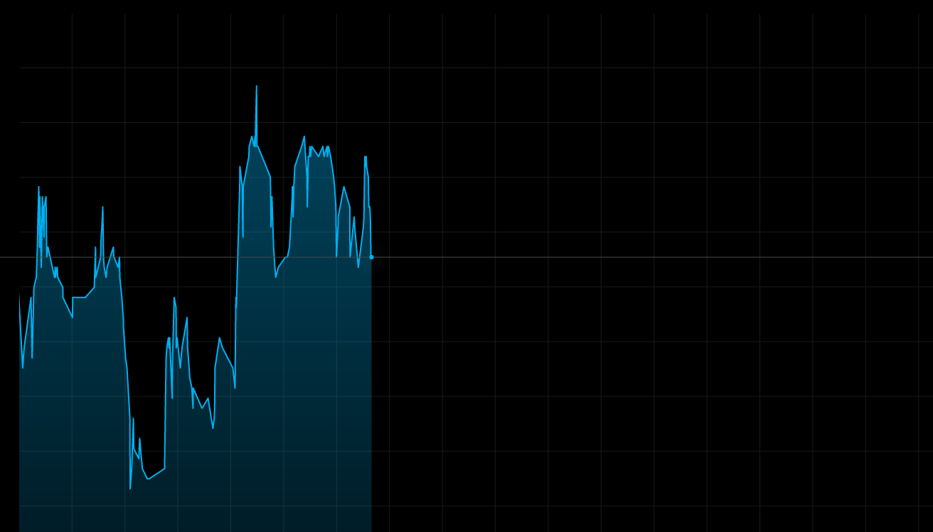

Hi guys,
We need from your help. We are using an area chart with gradient. After changing min/max on right axis gradient doesn't keep the original color. Is it possible to fix that? Thanks in advance.
Example page is here: http://en.1009.binarate.com/prosite/teechart ( here depend of dynamic prices and I'm not sure will see the bug ).
Code example:
function yz() {
            var l = sd[sd.length - 1][1],
             h = 0;
            for (var i = sd.length - 1; i >= 0; i--) {
                var dc = sd[i],
                    dcox =Chart1.axes.bottom.calc(dc[0])
                if (dcox > 0 && dc[1] > h) {
                    h = dc[1];
                if (dcox > 0 && dc[1] < l) {
                    l = dc[1];
                if (dcox < 0)
                    break;
            Chart1.axes.right.setMinMax(l * 0.99990, h * 1.00010),
            Chart1.axes.right.increment = (Chart1.axes.right.maximum - Chart1.axes.right.minimum) / 10;
Screencasts attached here below:
After changing
regular one

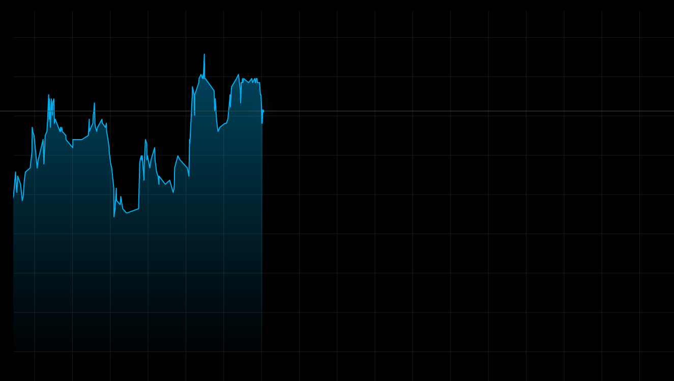

Re: Area chart gradient bug
Post by Yeray » Tue Nov 24, 2015 12:42 pm

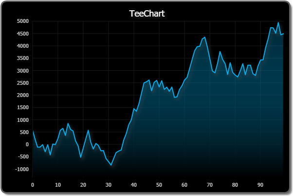

Here it is a simplified version of your example:
var Chart1;
function draw() {
  Chart1=new Tee.Chart("canvas1");
  Chart1.title.format.font.fill = "white";
  Chart1.legend.visible = false;
  Chart1.panel.format.gradient.visible = false;
  Chart1.panel.format.fill = "black";
  Chart1.walls.visible = false;
  Chart1.axes.bottom.grid.format.stroke.fill = "#191919";
  Chart1.axes.left.grid.format.stroke.fill = "#191919";
  Chart1.axes.bottom.labels.format.font.fill = "#ccc";
  Chart1.axes.left.labels.format.font.fill = "#ccc";
  var area = new Tee.Area();
  Chart1.addSeries(area);
  area.addRandom(100);
  area.format.shadow.visible = false;
  area.format.stroke.visible = false;
  area.format.fill = "black";
  area.format.gradient.visible = true;
  area.format.gradient.colors[0] = "rgba(0, 175, 240, 0.2)";
  var line = new Tee.Line();
  Chart1.addSeries(line);
  line.data = area.data;
  line.format.stroke.fill = "rgb(0, 175, 240)";
  line.format.stroke.size = 2;
  area.useOrigin = true;
  area.origin = area.minYValue() - 500;
  Chart1.draw();
This is how it looks:
Note I've used useOrigin and origin properties to set the bottom of the gradient.

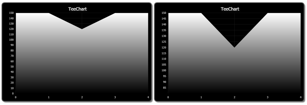

Hello, again

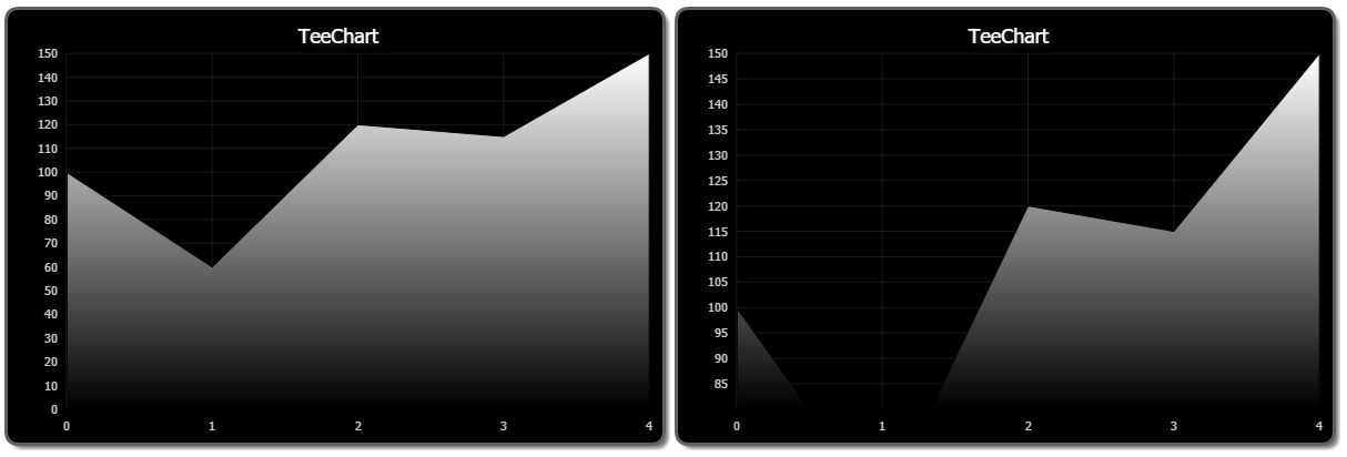

Thanks for the example page. I just changed the example and scrolled to the left side

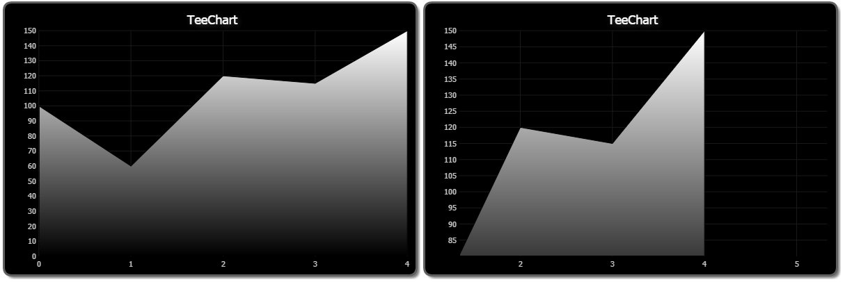

Post by Yeray » Wed Dec 09, 2015 2:50 pm
I see the gradient is drawn considering a rectangle with a height calculated taking this minYValue:
  this.minYValue=function() {
    var v=this.yMandatory ? Tee.Series.prototype.minYValue.call(this) : Tee.Series.prototype.minXValue.call(this);
    return this.yMandatory ? this.useOrigin ? Math.min(v,this.origin) : v : v;
In the code you've just posted, the smaller YValue on the series is 60 and origin is 80, so the Math.min(v,this.origin) call above returns 60 and the gradient is calculated considering the bottom of the rectangle at 60.
You can change that overriding the minYValue function for the area2. Ie:
        function draw() {
            area2.minYValue=function() {
            return this.yMandatory ? this.useOrigin ? this.origin : v : v;
            Chart1.draw();
            Chart2.draw();

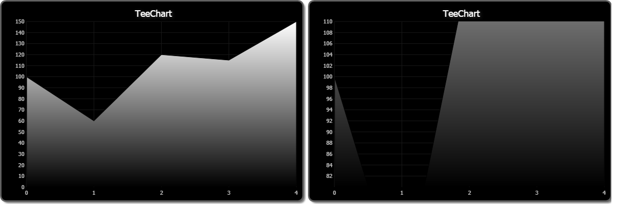

Post by g.todorov » Thu Dec 10, 2015 12:43 pm
It seems works but in our real situation we change min and max together with a near values.

Could you please give us a solution where the maxY is also included in the calculations if it possible of course.
In all cases we want to keep the gradient perfectly.
