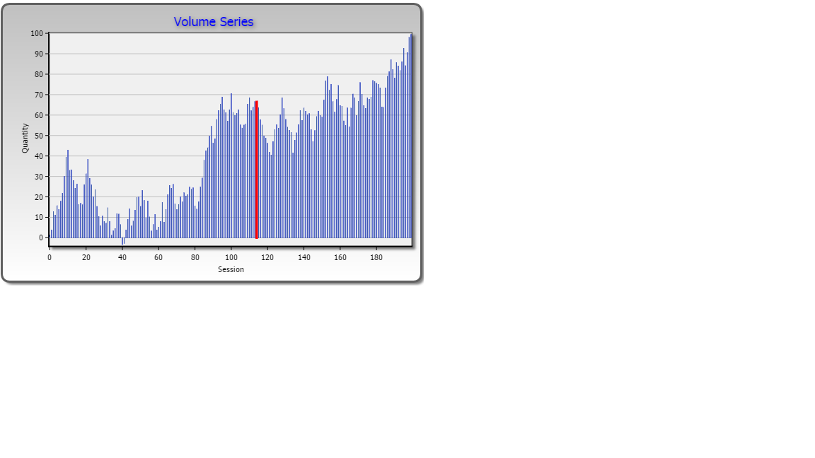

I'm trying to recreate the attached image using javascript. I want to highlight a specific bar with a specific colour.
Something like:
  Chart1.series.items[0].data.values[117].format.stroke.fill="red";
or
 Chart1.series.items[0].data.ValuesIndex[117].ValueColour("red");
How would I do that?
I'd appreciate any suggestions or help on how to achieve it. Many thanks.

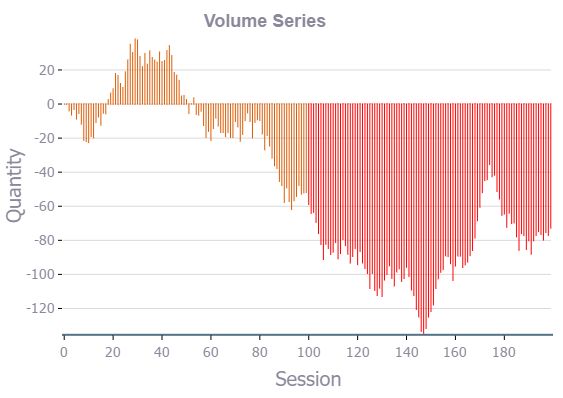

It does it for me here:

Post by Marc » Fri Apr 21, 2017 4:09 pm
Just checked and the latest inhouse, pre-release version contains a bugfix that resolves the Volume colour for this test code. For the current, publicly available version the test code will work for Bar Series, setting the fill colour for the bars but is not correctly applying to the Volume Series (Stroke Color).
We will publish the updated version at the beginning of next week for general availablility.
Apologies for the inconvenience caused.
