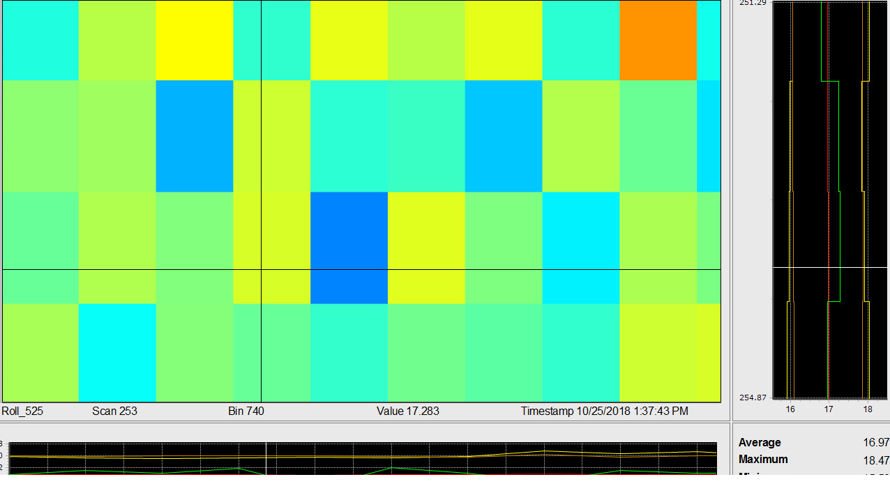

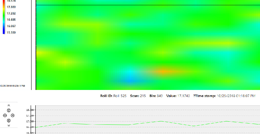

while Zooming how to make this color graph smooth zooming.Attached a screen shot where we are zooming using .net teechart control getting expected result.
Expected zoom.png (136.16 KiB) Viewed 50753 times
The example here seems to do the smoothed=false correctly.
