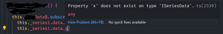

  • I have been facing package issues called "Teechart". there is no definition file in the package.
  • If I added manually Teecahrt with the definition file, there is a restriction to accessing some of the properties.

Then, Why I am getting this error?
Re: Is there any supports for Angular ?
Post by Marc » Mon Apr 24, 2023 3:44 pm
I can't tell why you're seeing that error. There's not a lot to go on from that screenshot.
I've uploaded the working example here:
https://github.com/Steema/TeeChart-Java ... ns/angular
Post by Marc » Tue Apr 25, 2023 2:09 pm
It looks like you need to download the change made at the repository or apply the comment:
//this.tChart1.applyTheme("minimal");
as described here:
https://www.steema.com/support/viewtopi ... 18&t=17897
