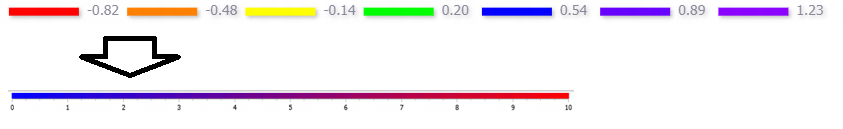

I would like to inquire about how to apply a legend to a ColorGrid chart as shown in the attached image.
thank you.

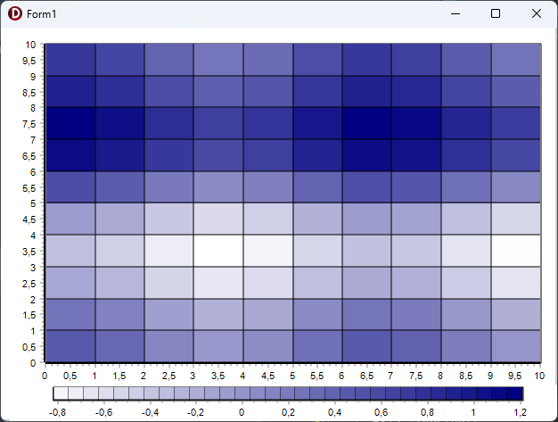

Have you tried the TLegendPaletteTool?
Here a simple example:
uses Chart, TeeSurfa, TeeLegendPalette;
var Chart1: TChart;
  Chart1:=TChart.Create(Self);
  with Chart1 do
    Parent:=Self;
    Align:=alClient;
    Color:=clWhite;
    Gradient.Visible:=False;
    Walls.Back.Color:=clWhite;
    Legend.Hide;
    View3D:=False;
    MarginBottom:=10;
    AddSeries(TColorGridSeries).FillSampleValues;
    Draw;
    with TLegendPaletteTool(Tools.Add(TLegendPaletteTool)) do
      Series:=Chart1[0];
      Vertical:=False;
      Width:=Chart1.Width;
      Height:=40;
      Top:=Chart1.Axes.Bottom.PosAxis+25;
      Axis:=laDefault;

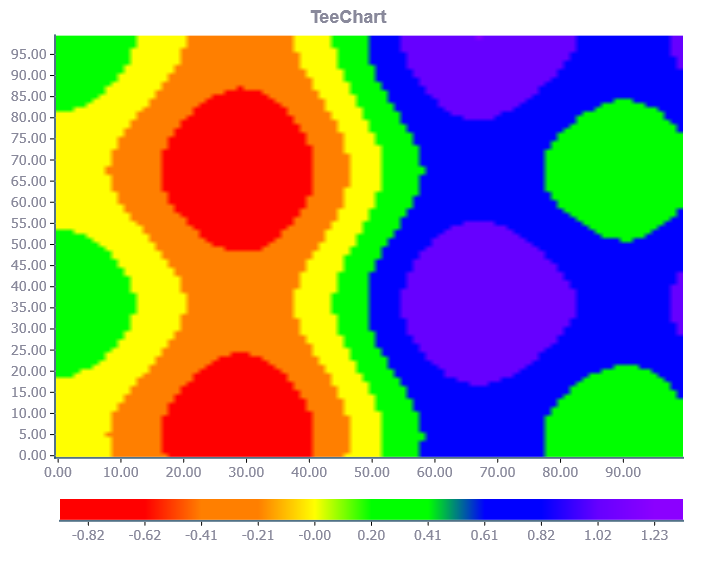

Post by yk.kim » Sun Nov 03, 2024 11:46 pm
https://www.steema.com/support/viewtopi ... 18&t=18141
I would like to contact you because the legend does not display the way
I want even if I change the position of the legend to "bottom" in the source link above.
주석 2024-11-04 084543.png (14.83 KiB) Viewed 59109 times
Re: I would like to inquire about how to apply a legend to a ColorGrid chart.
Post by Yeray » Mon Nov 04, 2024 9:39 am
You could try adding a second chart at the bottom and use it to draw the legend. Ie:
https://jsfiddle.net/norike82/7aj5p9of/

Thank you for suggesting a solution. :D
