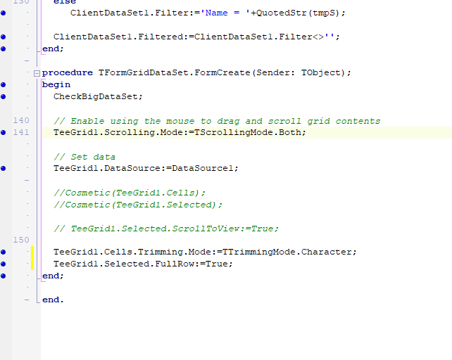

Here it is how it works for me:
Note I've added a line of code at the end of the FormCreate in that example to select the FullRow:
  TeeGrid1.Selected.FullRow:=True;
