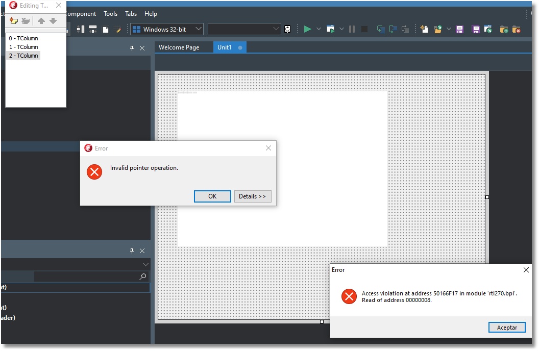

TeeGrid FMX invalid pointer operation on inheriting view
Post by johnny » Tue Nov 03, 2020 5:41 pm
Delphi 10.4.1
When inserting the teegrid to a form there is no problem, but when creating a new view Ejm: Andrid 10 tablet
and you want to add columns in the master view, there is a general bug and the whole delphi crashes
Re: TeeGrid FMX invalid pointer operation on inheriting view
Post by Yeray » Fri Nov 06, 2020 10:00 am
We should investigate that error.
If I add the columns in the Android view, switch to the master view and then add the columns again, then I see no error. Could you please confirm that?
