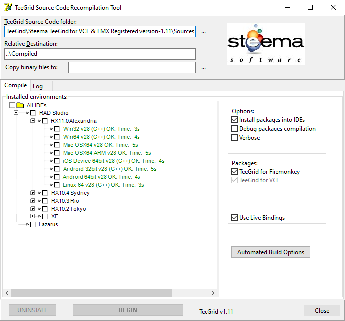

I see TeeGridRecompile builds TeeGrid 1.11 for linux platform in RAD 11 without errors:
But the "Compiled\Delphi28.linux64\Lib" folder doesn't contain any "FMXTee.*" unit. We'll revise it.
In the meanwhile, I've checked adding the "Sources" and "Sources\FMX" folders to the "Library path" for "Linux 64-bit" platform works fine.
