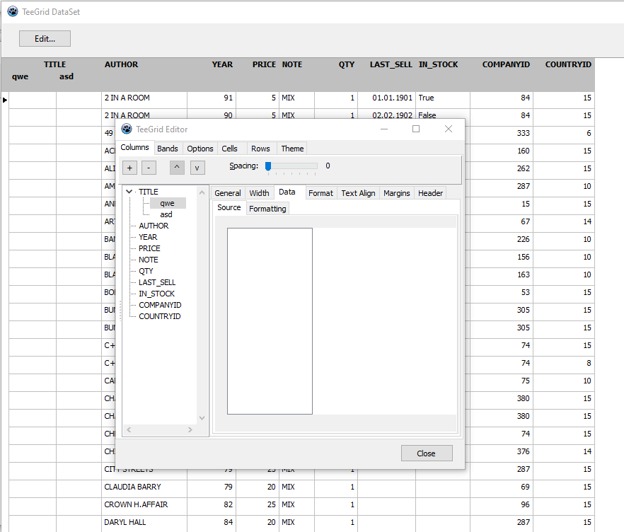

Yes, that's right, I added two columns. But, I cannot put the data inside.
For example, i want to move the "title" data inside the "qwe" column, and the "author" data inside the "asd" column.
scrn 2021-11-12 170918.png (10.22 KiB) Viewed 44951 times
This project is from the official demo.

Re: Sorting and Grouping data in Lazarus
Post by Yeray » Fri Nov 19, 2021 2:15 pm
I'm afraid the only way to do this would be using a different structure as explained here.
