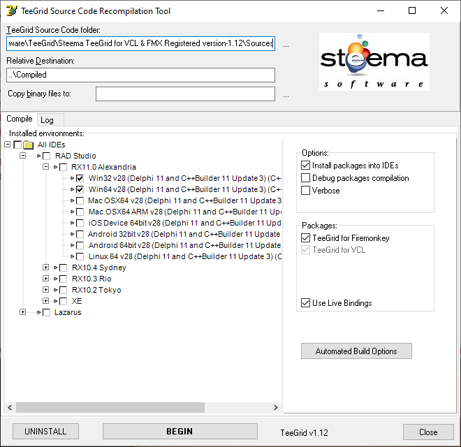

This time the error is when building for linux.
Please, select Win32 and Win64 only in TeeGridRecompile, not Linux.
When it finishes, open the IDE and add the "Sources\FMX" to the "Library path" for the "Linux 64-bit" platform, in a similar way as below:

Thanks, it worked. True, I did not understand what the problem with Linux is - there are all the necessary libraries for it. And the problem with Lazarus remains open - TeeGridRecompile.exe does not see it

Same for us here. We haven't found a way to make the compilation command (which works in the IDE) to work in TeeGridRecompile.
