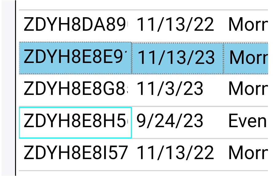

Post by TheOtherPrefontaine » Fri Nov 17, 2023 6:15 am
I've attached a small screen shot.
You can see the selected row, and also a light blue rectangle around the cell I just tapped on. So teegrid knows I tapped there since it painted the light blue rectangle, but its just not moving the selection.
Hope this provides a clue to what's happening. I really need this to work, as users on android will expect a tap to change the selection .
Thanks much!
