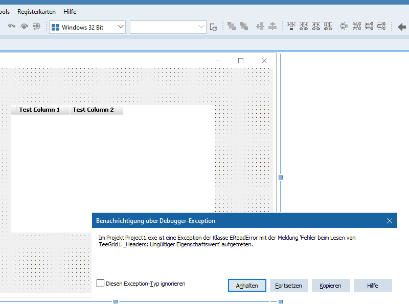

Before any application Window opens, the application throws an exception: "Invalid property value"
First
After clicking the button "continue" it shows a 2nd one.
What did I do wrong? Any help is appreciated.

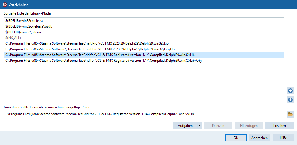

This is the first time ever we're using TeeGrid. There are no other versions in the search path. We do have TeeChart Pro installed, though. But I think this isn't the problem. All the paths have been set up by the installer.
Include-Path:
Library-Path:

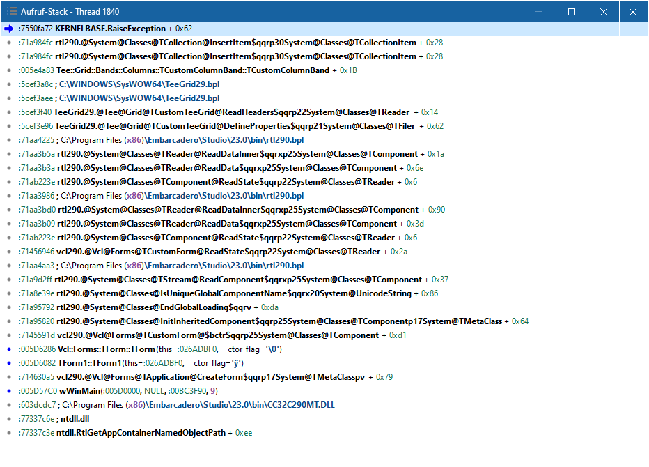

I've attached the two stack traces.
First exception:
Jochen H.
Posts: 7
Joined: Tue Sep 29, 2015 12:00 am
Re: TeeGrid V1.14 throws exception when trying to debug an application
Post by Jochen H. » Fri Jan 26, 2024 1:33 pm
Second exception:

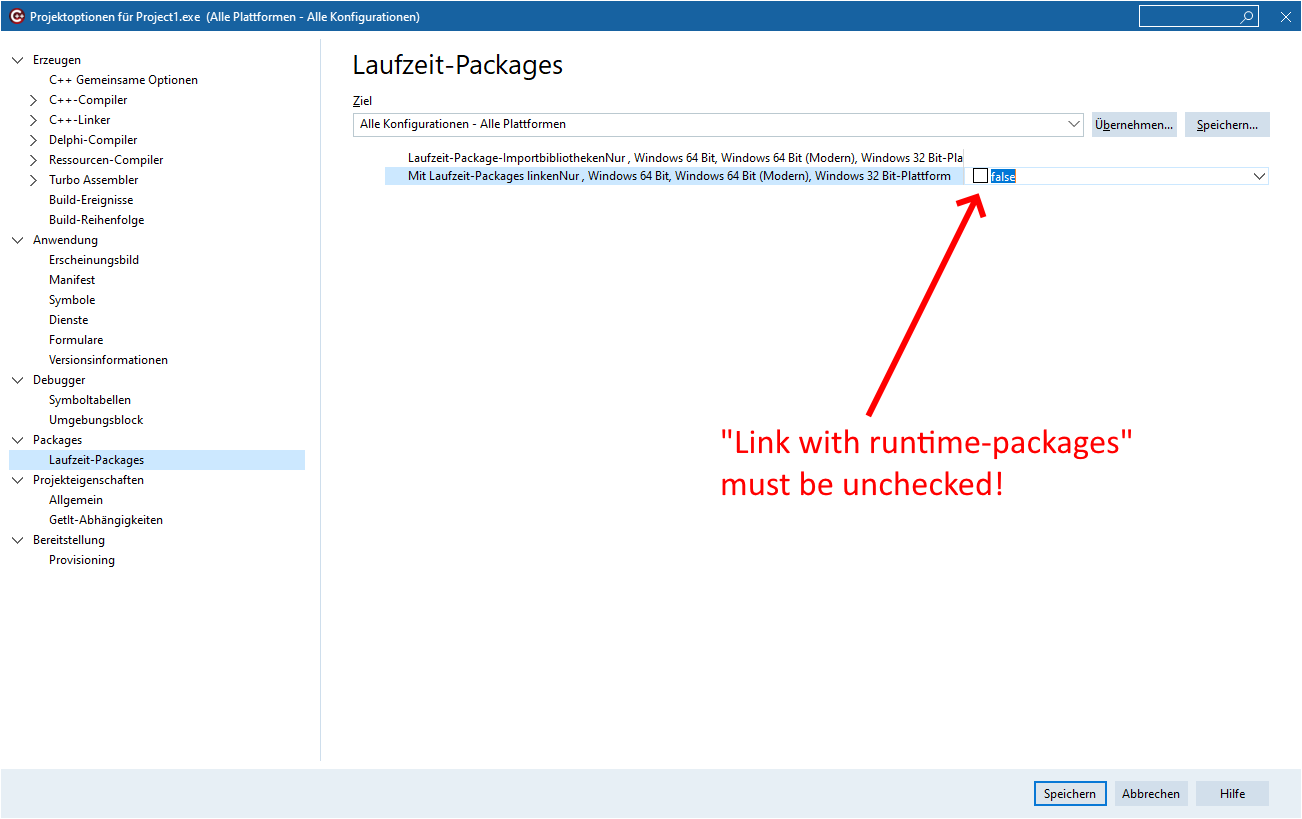

FIXED IT :D
In the project options "Packages" --> "Runtime Packages" one must uncheck "link with runtime-packages".
Can somebody please confirm this?

I just checked that. It runs ok with or without the 'runtime packages' selected. It may be something in the package list on your setup that is causing the problem.
TeeGrid is in the package list on the test installation here.

I've confirmed that the package "VCLTeeGrid" is in the list. When I try to start the application with runtime packages enabled it crashes upon startup like before. But now i've removed the runtime package "VCLTeeGrid" from the list and it works now with runtime packages enabled!!??
