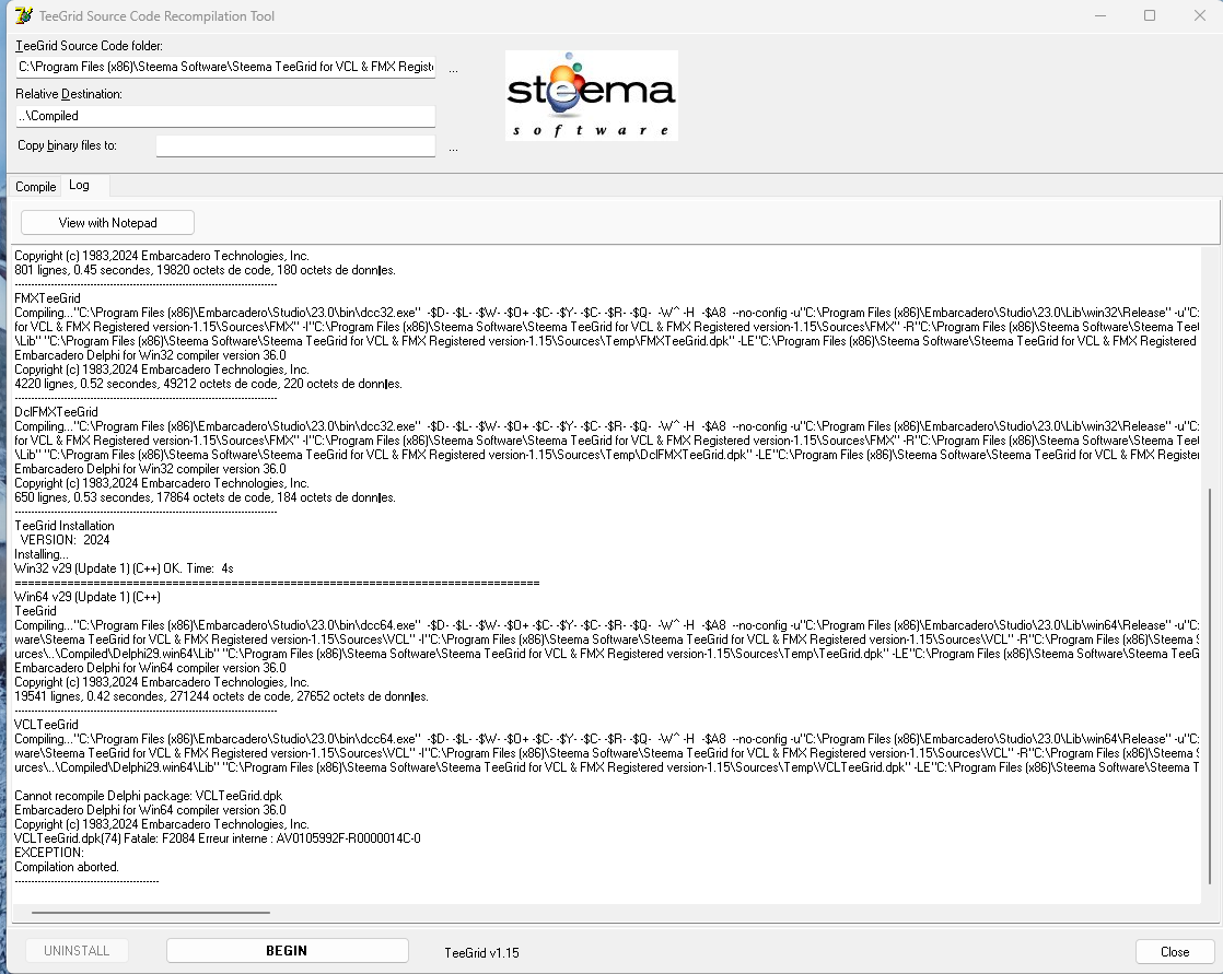

Good morning.
When compiling the 32bit versions runs without problems.
During 64bit compilation, execution stops with the following message:
Win64 v29 (Delphi 12 and C++Builder 12 Update 1) (C++)
TeeGrid
Embarcadero Delphi for Win64 compiler version 36.0
Copyright (c) 1983,2024 Embarcadero Technologies, Inc.
18932 lignes, 0.39 secondes, 264076 octets de code, 26596 octets de donn‚es.
VCLTeeGrid
Cannot recompile Delphi package: VCLTeeGrid.dpk
VCLTeeGrid.dpk(74) Fatale: F2084 Erreur interne : AV0105992F-R0000014C-0
EXCEPTION:
Compilation aborted.
Do you have a solution?
THANKS.
I hope my French/English translator isn't saying too much nonsense.

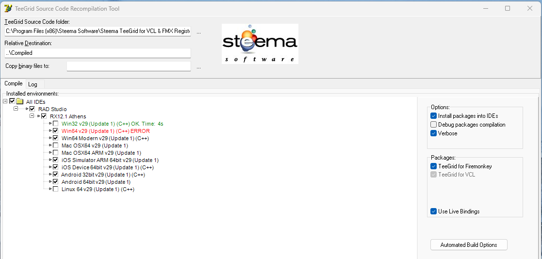

Installing TeeGrid 1.15
- TeeGrid Source Code Recompilation Log.png (97.62 KiB) Viewed 49525 times
- TeeGrid Source Code Recompilation Tool .png (53.01 KiB) Viewed 49525 times

Re: Installing TeeGrid 1.15
Hello and thank you for your answer.
I followed your advice, but the result is the same.
Oddly, the 64-bit Android compilation works without any problem.
When I look in the 'Compiled' folder I find two subfolders 'Delphi29.win64' and 'Delphi29.win64x' which themselves contain the 'Include, Lib and System' folders which contain the compiled files.
Is this enough for this to work or do we need to add a link in RAD Studio.
THANKS.
THANKS.
Hi.
I compared the installation directory with the one you sent me.
Many files are missing, the majority of which start with FMX.
I am attaching, by chance, the Log file of my installation which ends with an internal error which will perhaps make sense to you.
Thanks for your help.
D. Cavarroc
D. Cavarroc
- Log.zip
- (873 Bytes) Downloaded 1997 times
