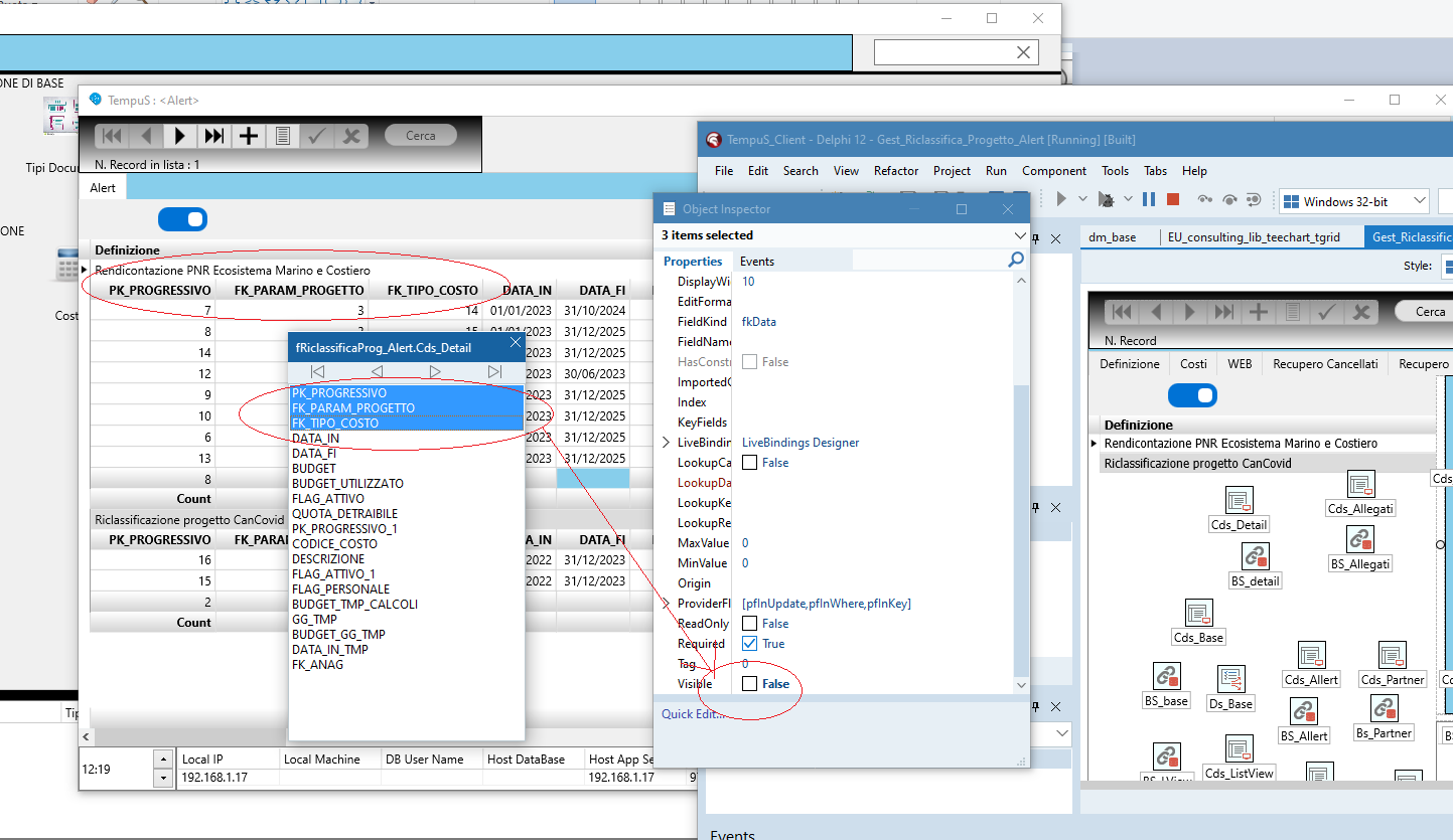

hi
still pertaining to the visible issue of persistent fields, I tried to make some code by adapting one of your examples to manage the expander
visible property at runtime doesn't work, the rest of the code works great
furthermore, changing the display label on the persistent field has no effect on the column title of the grid and this is a big problem, is there some instruction that I haven't found?
Help me please!
Am I doing something wrong?
(cds_detail is dataset in attach image)
Help me please!

- persistent field property visible
- field_property_expander.png (133.49 KiB) Viewed 57252 times

Re: clientdataset persistent fields property
Hi Marc
Thank you for your always prompt response
I used all the code you provided and improved it
I also solved the problems I reported to you and which I will try to explain better here
If anything you could create a small demo or a note for those who use your wonderful component whose wide possibilities I appreciate every day
The underlying issue is managing the runtime dataset that powers the expander
during the clone phase via the SaveToStream / LoadFromStream cycle the resulting dataset loses all the properties set in the original clientdataset
Example
ClientDataSet: My_dataset_input_for_clone
Persistent field: field_1, field_2,
Sets the object inspector properties
1) Field_1.visible = False
2) Field_1.displaylabel = 'field_1'
3) Field_1.displaywith = 30
4) Field_2.visible = True
5) Field_2.displaylabel = 'My_name_for_label_header' (modify from field_2)
6) Field_2.displaywith = 10 (change from 30)
the result is that
1 = true
5 = field_2
6=30
in practice it loses these properties
the solution is that when I exit the loadfromstream code I make the settings I need but this is inconvenient, very inconvenient.
the result is that
1 = true
5 = field_2
6=30
Sorry for my english
Ciao
Raffaele
