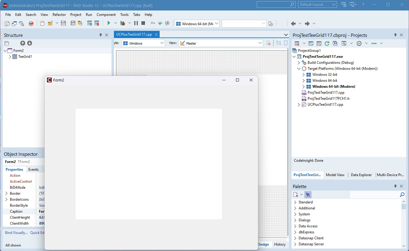

Re: _Headers : invalid property value C++ FMX (win32 only)
Post by Marc » Tue Mar 11, 2025 10:52 am
Yes, the error has appeared again for the latest C++ Windows x64 but works fine with modern C++ Windows x64. We'll take another look. Embarcadero recommends the use of modern.
