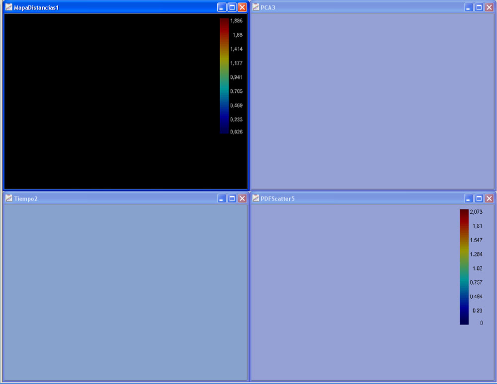

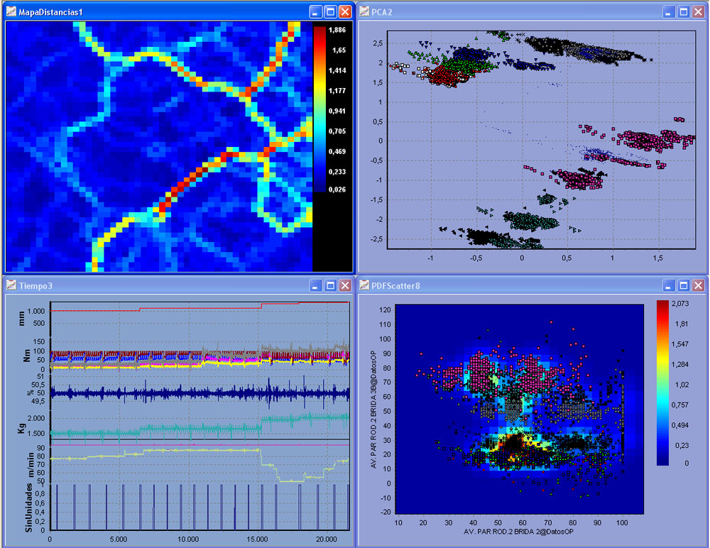

I uploaded two images for you to see how I currently see 4 of my graphs and how I see them using TeeOpenGL. As you may see, 2D series are not shown using TeeOpenGL, so I can't tell differences.
