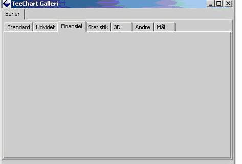

I have found one issue during translation of editor chart settings window to Danish language using "TeeSetDanish" procedure.
When I set editor chart setting to Danish language and try to change the series to Financial or stats, it shows empty. It does not behave the same when I change it other languages like fresh or Swedish.It works fine with other languages.
Find the attached screenshot with issue
Kindly let me know weather this is an issue or I missed any setting?

- The screen shot of an issue atatched

Hi Roopa,
Yes, it seems really strange! I've added it to the wish list to be fixed asap (TV52014287). I've also noticed that the financial series (Finansiel) reappear (and its tab returns to english) after navigating through functions (Funktioner).

Thanks for the feedback Yeray,
It would also help if you could let us know by when we could expect a new patch with this issue resolved since we have to provide our users with a support for this issue in our product as well.

Hi Roopa,
I'm afraid we haven't still fixed a date for the next maintenance release and I even can't ensure that this will be solved on it, but I've added this bug with high priority in the list.
