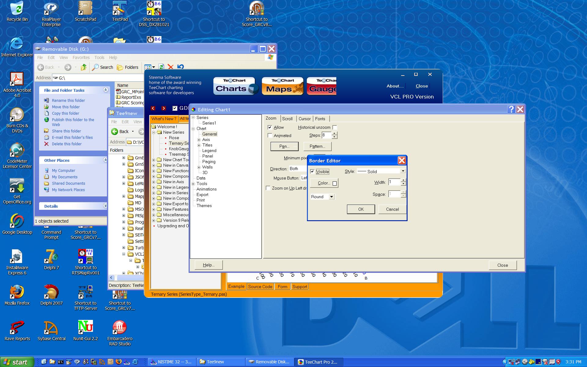

For example using a notebook with screen 1920 x 1200
Open Editor
Select General tab Zoom
Select Pen you cannot see Width and Space editors
On this dialog the caption "Border Editor"
The righthand side hides most of the text and the spineditors
the box does not resize with screen resolution correctly ?
Mike
Open Editor
Mike

Re: Problem with editor dialogs
Attached is screenshot
Hi Mike,
Thanks for the image. The problem I see here is not screen resolution but Windows' fonts set to "large fonts (120 DPI). This is a known issue (TV52011726) we will try enhance for future releases. Works fine with 96 DPI fonts. Can you please confirm problematic environments use 120 DPI fonts?
Hi Narcis,
You've got it correct.
In most cases with the high/dense screen settings, the large font is greater than 96 dpi.
On 96 dpi machines it's fine
Mike

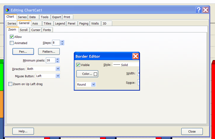

Hi madupree,
I cannot reproduce the problem in TeeChart 2010. Could you please confirm it? (You can download the eval or run the precompiled demos)
Yes it is much better in VCL2010 using the Demos.
How ever it is close to cutting off the right edge (see attachement)
However it is usable
