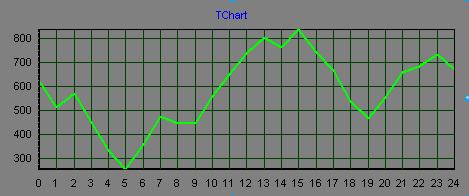

I am finding it difficult to create a line graph with nice smooth lines between points. For example, in the TChart below I consider the lines to be very "jagged":

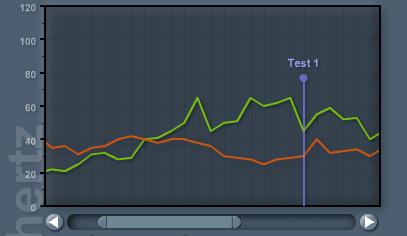

Below is a graph I found off another website:
(see it for real: http://www.maani.us/xml_charts/index.ph ... bmenu=Line )
I just can't seem to create charts which have nice smooth lines. It seems a lot of other graphic solutions are rendering charts with much greater eye appeal.

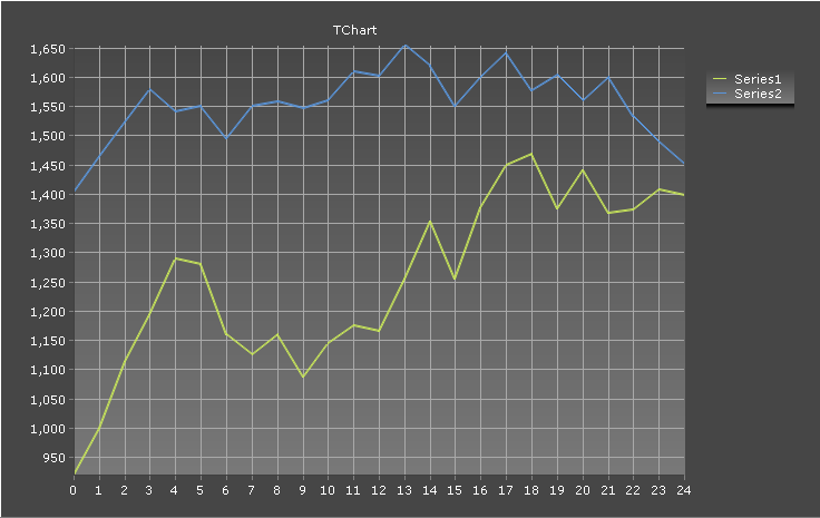

You could use AntiAlias to get nicer smoothed lines:
uses Series, TeeAntialias, TeeThemes;
var AntiAliasCanvas: TAntiAliasCanvas;
    i: Integer;
  Chart1.View3D:=false;
  AntiAliasCanvas:=TAntiAliasCanvas.Create;
  Chart1.Canvas:=AntiAliasCanvas;
  ApplyChartTheme(TBlackIsBackTheme, Chart1);
  for i:=0 to 1 do
  with Chart1.AddSeries(TFastLineSeries) as TFastLineSeries do
    Pen.Width:=2;
    FillSampleValues;
