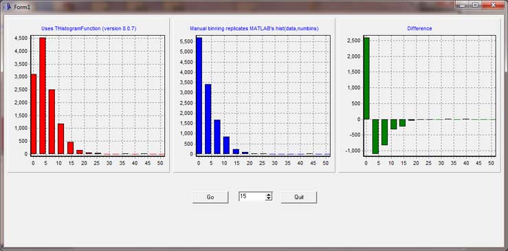

I'd appreciate some insight into why there is such a discrepancy between data binned by THistogramFunction and MATLAB's binning. The attached code uses my own method for binning (a standard method) which reproduces MATLAB output exactly. The differences are even more remarkable and disconcerting when using much larger data sets (I regularly use 70000+ raw data points), which significant consequences for statistics applied to the binned data. The differences between these methods are not just manifest at the beginning of the distributions, but appear throughout.
Clearly I'd like to discover that I'm doing something fundamentally wrong in my use of THistogramFunction which, if rectified, would match manual/MATLAB binning, but I'm not confident that this is where the problem lies. At the moment this is a major problem and cause for concern; any help would be very much appreciated indeed.
Attachment is for C++ Builder 5.1 and TChart 8.0.7; I get identical results in RAD C++ 2009.
- CB5 binning.7z
- source and data file
- (384.32 KiB) Downloaded 825 times

The source of the discrepancy is in the binning algorithm of TeeHistogram.pas. In
the use of Round() function seems to me to be inappropriate. Round() probably uses Banker's rounding which means odd and even numbers are treated differently. Replacing Round() with Trunc() has the desired effect, making the values compatible with C/C++, MATLAB etc. Thus:
I'm also not convinced of the use of 0.5 in setting bin centerpoints a few lines above in the same file. Using
gives more intuitive results (others may disagree, and my impression may just be contextual).
One could edit TeeHistogram.pas in the source folder, or create a modified version of the file and function (and edit up some of the other source/Make/dpk files to make them aware of the new function), and run TeeRecompile.exe to rebuild and install the mod.

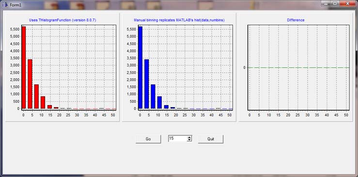

procedure Histogram(Data: TChartValues; var bins,counts: TChartValues; Min,Max: Double; nbins: Integer);
j := Trunc((data[i]-min)*invbinwidth);
bins[i] := min + i*binwidth;
- using Trunc()
- trunc.jpg (57.27 KiB) Viewed 18194 times
- using Round() - the difference is obvious
- round.jpg (59.73 KiB) Viewed 18182 times

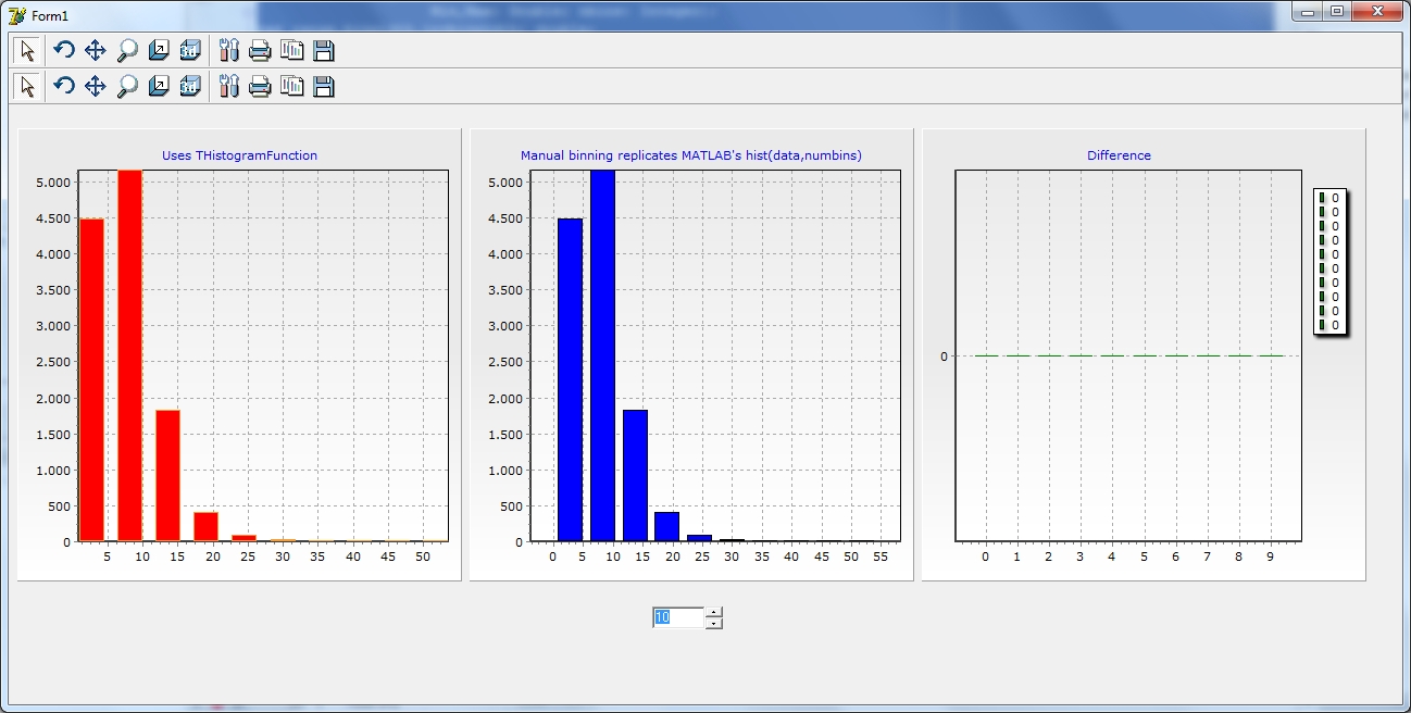

I attach a Delphi example, similar to yours, which I created to be able to easily debug sources and which produces this chart:
Thanks for your feedback.
Yes, that's correct, see Delphi's Round method documentation.the use of Round() function seems to me to be inappropriate. Round() probably uses Banker's rounding which means odd and even numbers are treated differently.
It's not necessary as our current v8 and v2010 (aka v9) sources already produce same results as you'd expect. I bet this is due to a bug (TV52012772) fix which was discussed here. Actually TV52012772 was fixed for v8.07 as can be seen in the release notesReplacing Round() with Trunc() has the desired effect, making the values compatible with C/C++, MATLAB etc.
- D2009_v8.zip
- (20.97 KiB) Downloaded 766 times

yes (RAD 2009). I was just looking at it just now. It compiles and runs fine. The THistogramFunction (left) and manual binning chart (middle) are identical, with no difference (right chart).Narcís wrote: Do you have any Delphi version for trying the project I attached and check if it works fine for you? At the URL below you can download the exe I generated with my sample project. Can you please check if it works as expected at your end?
However, the manual binning routine in
procedure TForm1.Edit1Change(Sender: TObject);

Continuing with what I said above, we decided to add a new property to THistogramFunction called DataStyle of type TDataStyle which is an enum with those possible values: hdsTruncate and hdsRound; the first one being the default value. So, from now on, by default, you'll get histograms calculated as in the code imitating MATLAB you sent. To get previous versions histograms you can set DataStyle to hdsRound, for example:
I'll send you TeeHistogram.pas so that you can test this new feature at your end. This property has been added both in v8 and v2010.
TeeFunction1.DataStyle:=hdsRound;

Paths were ok. I purged the compiler of add-in components, and checked .bpr for vestigial v2010. Whatever non-standard thing it was I did worked. You can safely assume it was a local issue.Narcís wrote:Hi philip,
Really? That's strange, it works fine for me here in v8 directly referencing the sources from Delphi. You could try adding the source code path at Tools -> Options -> Environment Options -> Delphi Options -> Library - Win32 -> Library path. Does this work for you?
Anyway, it [your .pas modification] works fine (ChartEditor still to do) - as it should.
