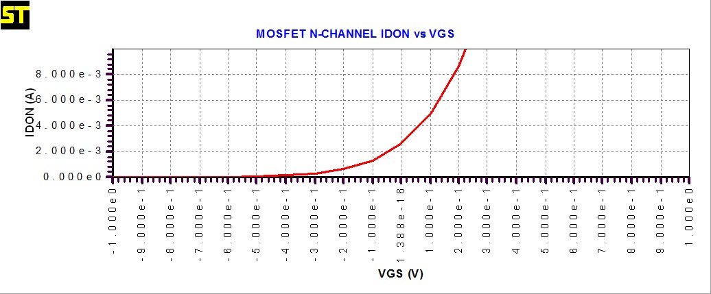

When I have an axis with negative and positive values the axis text values are correct except for the zero (0) value which is some small number like 3.943E-16. How can I make this display the value (0) instead? See image below (I hope the image comes through.

The data points are correct. When I click on the series the data has, for example (-.3, -.2, -.1, 0, .1, .2, .3). The chart is initialized at runtime and then the data is added as the program is run one point at a time. The chart initialization includes the axis minimum (e.g. -.3) and the axis maximum (e.g. .3) and then the chart is displayed before the data points start coming in. The chart text for the axis is, for example ( -.3, -.2, -.1, 3.267e-16, .1, .2, .3). and it this text I would like to change so that the zero point actually has "0" for the text.

I believe I now have the picture attached.
