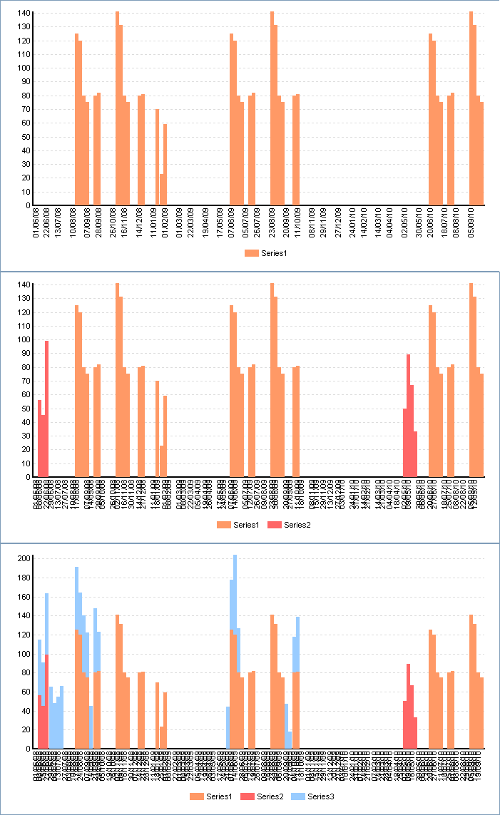

I'm having similar problems. The separation appears to be fine when there is one series on the chart, however when you add a second, third, fourth series and so on, the separation disappears as multiple labels are placed on the axis.
The labels for each series are absolutely identical and are weekly dates, but everytime you add another series the spacing gets worse and worse as it displays more labels. Take a look at the attached image file where you can see the axis labelling changing as each series is added.
I'm having exactly the same problem with every chart that includes multiple series. We have made no changes to our code which worked perfectly well in v8 and have just upgraded to v2010 as we're now using Delphi XE.
Any advice greatly welcome?
- Same chart with a series added each time. Look at the bottom axis labels.
- TChartAxisLabellingIssue.png (42.11 KiB) Viewed 17389 times
