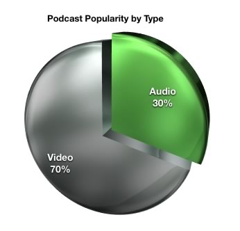

I've attached 3 example pie charts (which i found with google) that give the exact look and feel of the kind of chart I want.
I'm experiencing difficulties with creating these kind of charts with the TeeChart VCL Components.
I've also attached 2 demo-charts which shows what I've managed to build with TeeChart VCL.
Can you please have a look at the pictures (specially at the colors, color combination, shine, lights, shadows, edges, edge and (border)line smoothness, reflection, style) of the example pies and the one I've managed to create?
You will see very very very big differences.
Is it possible to create such charts with TeeChart? If so, can someone please help me with this?

- Example3.png (29.02 KiB) Viewed 17735 times
- Example2.png (26.76 KiB) Viewed 17706 times
- Example1.jpg (10.75 KiB) Viewed 17678 times

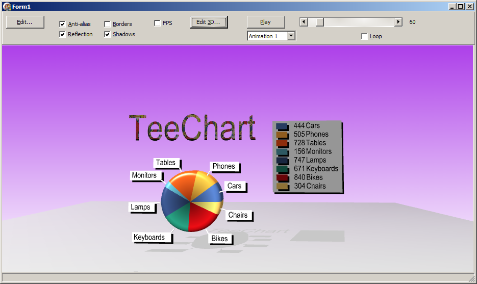

- TChart3D.jpg (90.02 KiB) Viewed 17692 times

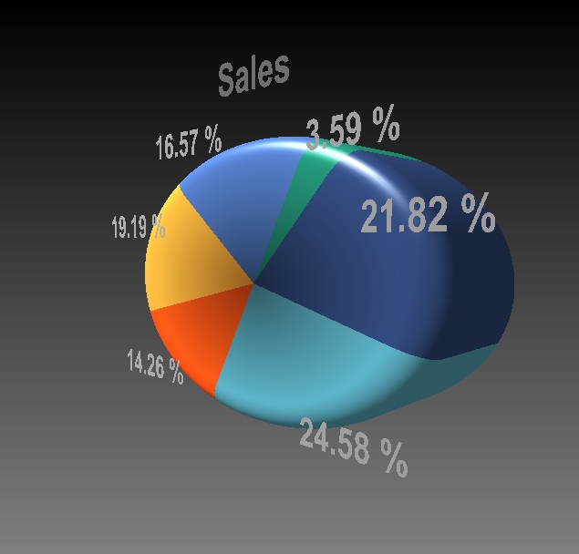

- TChart.png (90.23 KiB) Viewed 17674 times
Re: Look and feel VCL Charts
Hello Invers,
Sorry for the delayed reply. TChart3D components are being enhanced considerably for the next TeeChart Pro 2010 VCL maintenance release. We think that with those enhancements you should get much closer to the charts you posted. We'd like the version to be out before the end of the year or during January 2011 at most.

The second picture (TChart.png) is made with the regular TChart, probably with TeeGDIPlus and using the new properties for the TPieSeries: EdgeStyle, BevelPercent and Transparency. There is an example of these properties usage in the v2010 features demo, and an example of the TeeGDIPlus usage can be seen in v8 features demo too.
However, I recommend you to try the v2010 evaluation version and looking to the features demo (included with the eval and the Pro binary version).
The first TeeChart picture posted by "Invers" (TChart3D.jpg) is made with TChart3D component, a 3D oriented version of TChart. It's a little bit more complicated to use, so we recommend to get used to the regular TChart before starting with TChart3D.Calou wrote:I use Tee chart V8. If i want to have this look on my charts (i don't use GDI) and i upgrade to V2010, is it complicated to do this?
Your old Charts made with v8 shouldn't change when updating to v2010.Calou wrote:Will all the actually chart's behavior of my application will be maintained?

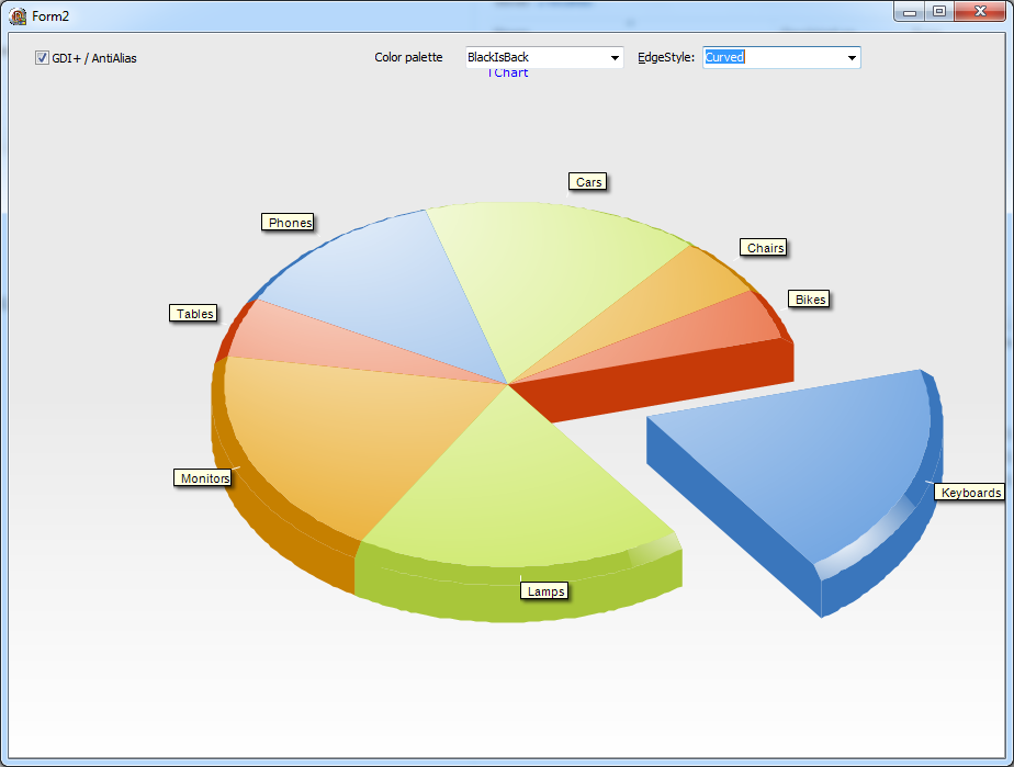

Here it is an example of the latest improvements on this. Here it is how it looks: Your feedback will be appreciated.
