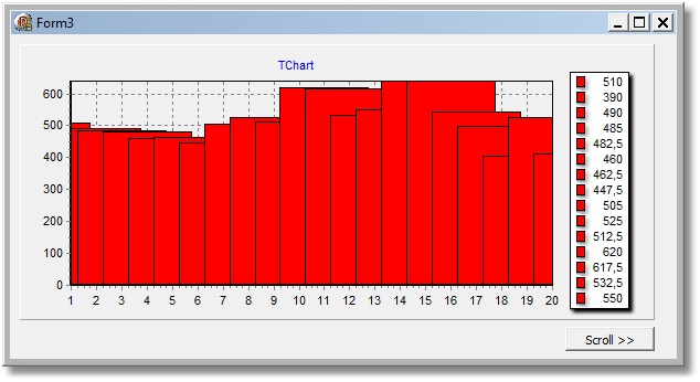

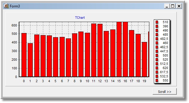

If you setup the property Points per Page you will see the problem.
The first image shows the graph when the application fires up (as suggested by your example).
The second image shows the graph after I press the Scroll button that trigger Chart1.Axes.Bottom.Scroll(1);
Please, see the images below:
Before Scroll:
Before Scroll
After Scroll:
After Scroll
