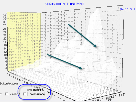

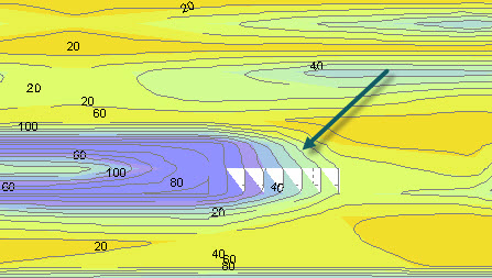

Does anybody know the setting to resolve these incorrectly filled surfaces on a contour and IsoSurface series?
21-Apr-12 10-58-30 AM.jpg (97.51 KiB) Viewed 13933 times
21-Apr-12 10-58-58 AM.jpg (86.06 KiB) Viewed 13935 times
21-Apr-12 11-05-49 AM.jpg (59.06 KiB) Viewed 13941 times
This seemed to have occurred since upgrading to TeeChart Pro 2012.05.120327, but i cannot seem to resolve.
The holes are not in my data. There must be some setting but I cannot find it.

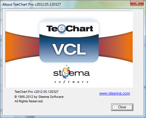

On the computer with the issues, I am now definitely running
25-Apr-12 9-36-20 PM.jpg (46.86 KiB) Viewed 13842 times

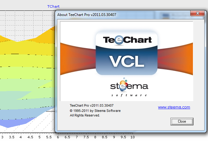

Hi Trevor,
I found the v2011.03 seems to work fine for me here with your application. Could you please give it a try?

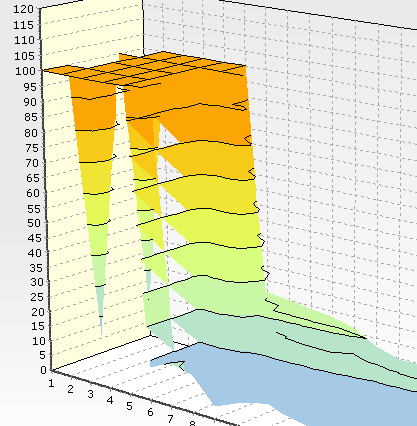

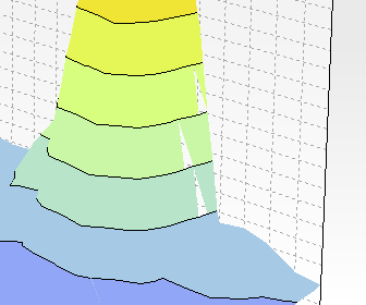

I downloaded and installed 2011.03 Delphi6 (binary installer version)
Unfortunately, the problem was not resolved with that version.
06-May-12 6-34-29 AM.png (8.06 KiB) Viewed 13713 times
06-May-12 6-54-26 AM.png (19.42 KiB) Viewed 13713 times
I could never get the 2012 source code installer to work, see: http://www.teechart.net/support/viewtop ... =3&t=13167, so I only had the 2012 binary installer working.
I downloaded and installed the source code version for 2011.03, and the result was exactly the same as above
