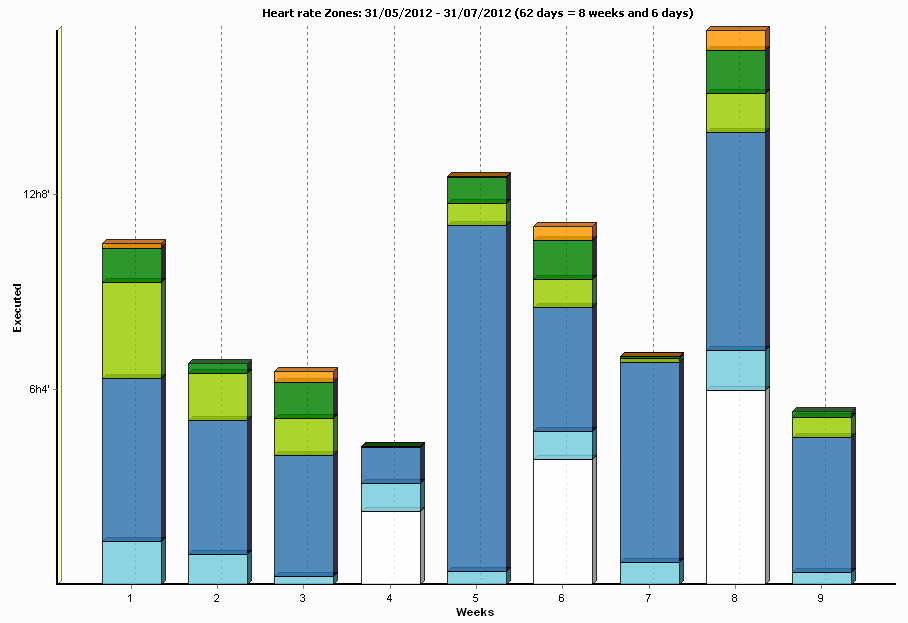

I have groups of bar series in a chart, with 2 stack groups.
Each color and group is a bar series.
I have the MultiBar property set to mbStacked, and StackGroup set to 0 for first group and 1 for the second.
Each group is on a custom y-axis, bottom axis is shared for all series.
The bars of the groups do not lign up on the bottom axis, while with a single group they do. See attachments.
Is there any way to make them lign up when stacked ?

The stacked style wasn't thought to be split in different axes. That's why an offset is applied to the groups. However, this offset could be undone ie using the OnGetBarStyle as follows (having 2 stack groups):strobbekoen wrote:Is there any way to make them lign up when stacked ?
Procedure TForm1.SeriesGetBarStyle(Sender:TCustomBarSeries; ValueIndex:Integer; var TheBarStyle:TBarStyle);
if Sender.StackGroup=0 then
Sender.OffsetPercent:=50
Sender.OffsetPercent:=-50;

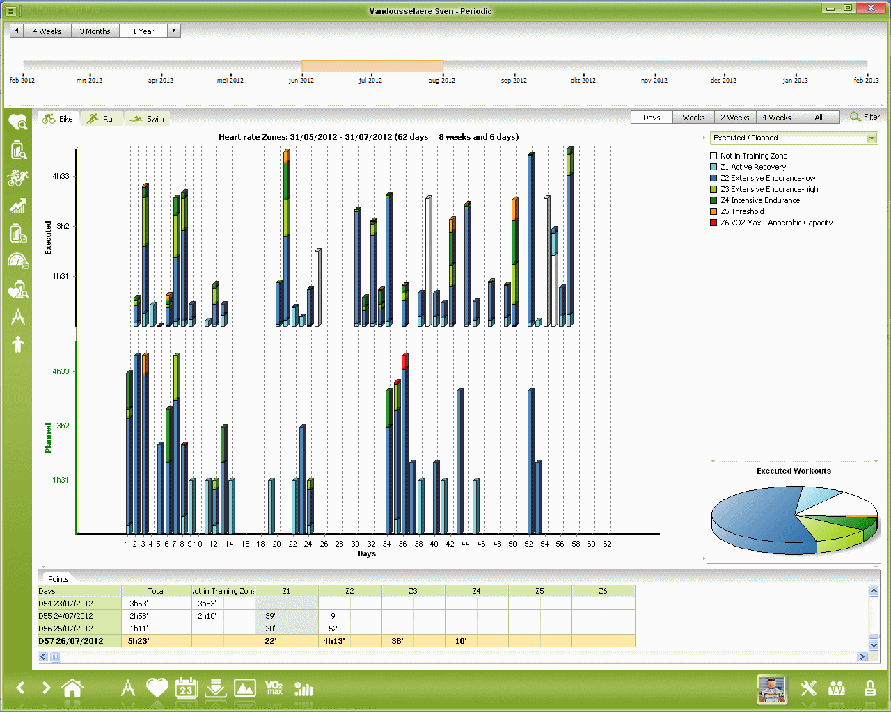

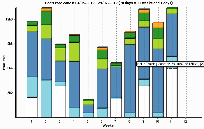

Since I create the series at run time, I set the OffsetPercent directly when creating the series instead of using the event.
I attached a few more shots:
iqo2_periodic3 and iqo2_periodic4 display the same period in weeks, but one with a single stackgroup, the other with two.
You can see the bar width has changed, I assume because the chart calculates the bar width thinking the bars of the two stackgroups will not be aligned on the bottom axis (as was the issue originally); so there is more white space.
Is it possible to remove this white space and get the same bar widths as for the single stackgroup ?

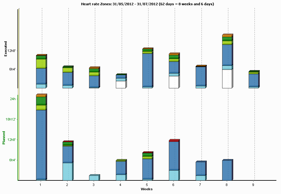

iqo2_periodic4 displays the same period as above in days (so there are more points).
I use Chart3DPercent (set to 5) to display the bars in 3D.
The bottom axis ticks (with the labels) are in the center of the front of the bars, while the grid is aligned to the center of the back of the bars.
As the bars get more narrow, this creates a visual effect that the bars are slightly misaligned (alignment is actually correct though).
As far as I can think of is to calibrate the 3D percentage according to the number of data points instead of a fixed value.
Or maybe you have a better alternative ?
Many thanks.

You could use the CustomBarWidth property to define the bars width. However, it means this width should be calculated by you. Find below an example of it:strobbekoen wrote:iqo2_periodic3 and iqo2_periodic4 display the same period in weeks, but one with a single stackgroup, the other with two.
uses Series;
var nGroup, nSeries, tmpWidth: Integer;
Chart1.Legend.Visible:=false;
Chart1.MarginLeft:=10;
for nGroup:=0 to 1 do
with Chart1.CustomAxes.Add as TChartAxis do
StartPosition:=nGroup * (100 div 2);
EndPosition:=(nGroup + 1) * (100 div 2);
for nSeries:=0 to 4 do
CustomVertAxis:=Chart1.CustomAxes[nGroup];
OffsetPercent:=50+(nGroup*-1)*100;
MultiBar:=mbStacked;
StackGroup:=nGroup;
Marks.Visible:=false;
Transparency:=20;
FillSampleValues(10);
if nSeries=0 then
Chart1.Draw;
tmpWidth:=Round((BarWidthPercent*0.01)*(GetHorizAxis.IAxisSize div 11));
Chart1.Axes.Bottom.MinimumOffset:=tmpWidth;
Chart1.Axes.Bottom.MaximumOffset:=tmpWidth;
CustomBarWidth:=tmpWidth;
I don't know what will be the best alternative, but I can think on:strobbekoen wrote:iqo2_periodic4 displays the same period as above in days (so there are more points).
- Use the AxisBehind (true by default) to move the grid to the front:
Chart1.AxisBehind:=false;
All this still gives an unaligned aspect.
Chart1.Chart3DPercent:=5;
with Chart1.Axes.Bottom do
ZPosition:=100;
TickLength:=10;
Chart1.Axes.Bottom.Grid.Centered:=true;
Chart1.Axes.Bottom.Grid.Visible:=false;
