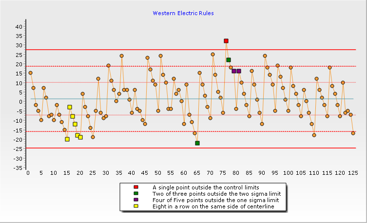

A look on your SPC-Sample in the Demo -> New Features -> Functions -> SPC gives rise to some questions for me. Im my opinion some of the points of the series a clear outliers beeing more than 3 standard deviations from the mean, so clear "out of control". They do not follow your rules beeing presented in the legend. What ist the reason for some points beeing presented as squares when others are shown in circles?
A squared pointer is to mark that a point accomplishes at least one of the rules implemented. This is what I get with the demo here:
Could you point to the points you think are not marked correctly? Otherwise, can you send an example demonstrating that?

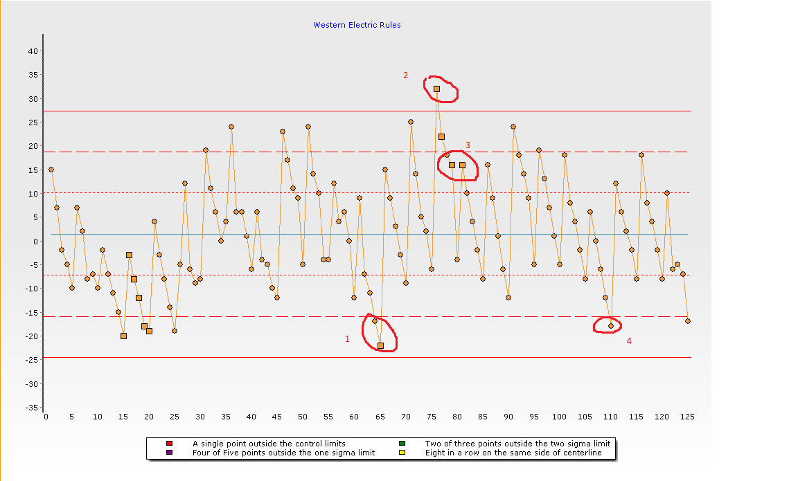

Post by McStep » Fri Mar 22, 2013 3:32 pm
Hi Narcis,
First of all. I 'm thankfull for your help and soon responses.
Your QC-Chart definitely looks different from the charts I get in the demo.
[img]
[/img]
All Points are shown in the same color. I can't find the reason, why for example the first point in area marked 1 is a circle and the second is a square, The second area shows two outliers where both points are squares. In area marked with 3 I can 't figur out the rules, why the two points are shown as squares.
I agree that the grafik you presented looks much better.
What did I miss in my demo?

Re: Invalid units in uses clause of demo
Post by Narcís » Fri Mar 22, 2013 3:46 pm
Hi McStep,
I could reproduce this problem with the demo compiled with latest binary installers. The image I sent is generated with the demo compiled with our internal sources so probably it was a bug that has been fixed. We can try to compile a new demo and send it, if you like. Otherwise you may expect it to be fixed for the next maintenance release.
