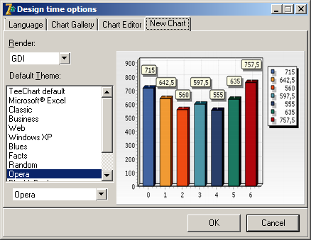

That's strange. By default, with GDI+ selected (as per default) as "Render" option at the "New Chart" tab in the "Options..." dialog opened from the contextual menu at design time:

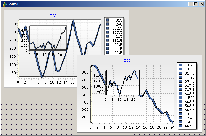

I get GDI+ Charts, both at the parent chart and at the subchart:
However, if I open again the options dialog and select GDI as "Render" option at the "New Chart" tab, still at design time:
And I drop another chart to the same form, I see GDI in both the chart and the subchart:

You should be able to go back to GDI as mentioned above.
Alternatively, you can force it at runtime with:
uses Series, TeCanvas;
  Chart1.Canvas:=TTeeCanvas3D.Create;
