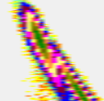

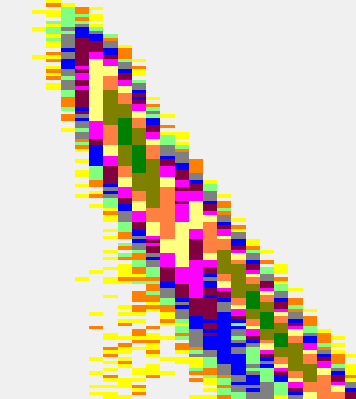

Why TColorGridSeries has has great difference for GDI and GDI+ render?
This can be seen in attachments.
- GDI+Render.png (76.82 KiB) Viewed 21978 times
- GDI_Render.png (4.15 KiB) Viewed 21960 times
With best regards
Vladimir
Vladimir

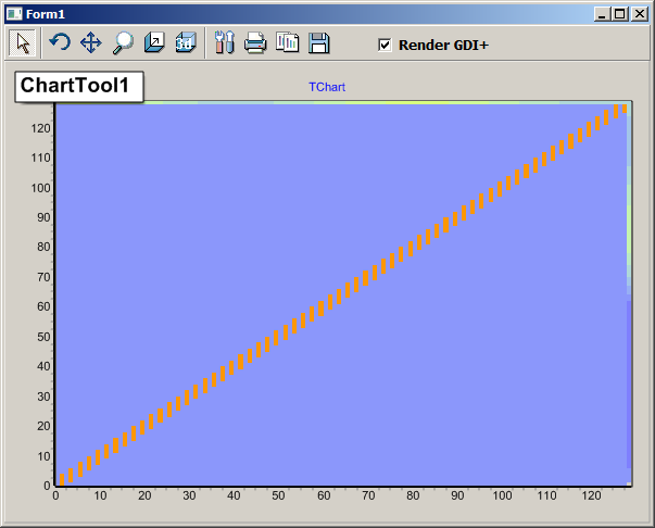

There is new bug with the latest TeeChart2013, also exists in beta.
Will try using this example (for GDI & GDI+) to print chart image:
On my HP printer the the printout is not the same as preview, bad annotation tool and very big size of axis fonts,
will check GDI and GDI+ modes, they have different printouts!

Hi Yeray
I can reproduce this printout bug with my previous example for CBuilderXE5, (I have not DelphiXE5).
Simply you can press print button on TeeCommander in GDI+ mode, GDI mode has not this bug.
Print Preview is normal, but on paper there is a bug.
I've checked both examples(your and my) using RadStudioXE4, but with TeeChart2013forRadStudioXE4.exe,
its work fine for printout.
