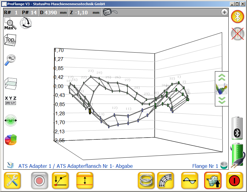

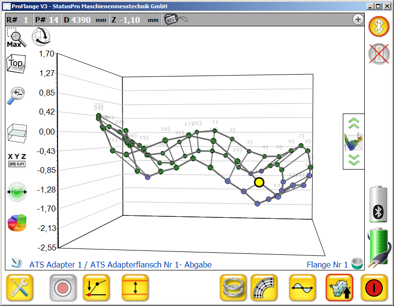

I'd like to draw a Point3D series like it is drawn in 2D.
Currently if I turn the chart (Rotate Tool) the points are drawn as ellipses with perspective deformation applied to them.
I'd like to see them as simple circle from all views.
Best would be to have "bubbles" or "balls" like it is 3D - but simple circles are good as well.
a few pictures to demonstrate it:
Scaling the points by depth would be OK but not necessary.
Thanks for any ideas !
Drawing Point3D series without perspective in FullRotation
- Newbie
- Posts: 12
- Joined: Mon Feb 17, 2014 12:00 am
- Points as ellipses
- Flange2.png (153.82 KiB) Viewed 9882 times
- View of Points like circles
- Flange1.png (157.91 KiB) Viewed 9885 times
