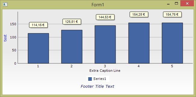

Re: Series Caption and Legend Overlap
Post by Narcís » Fri Oct 17, 2014 8:34 am
Hi Ed,
With the modifications David Berneda made to the code it's working fine now:
So you may expect this being fixed in the next maintenance release. If you are interested, you can also check David's new beta version here.
