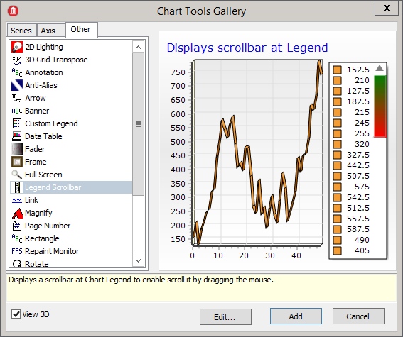

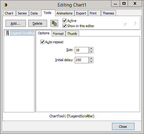

joepasquariello wrote:1) TLegendScrollBar is not in the component pallette. Should it be?
It is in the Tools tab in the Chart editor, isn't it?

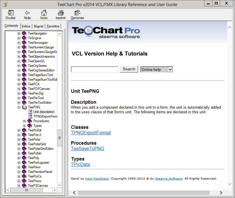

joepasquariello wrote:2) There is nothing in the help on TCursorTool, SaveAsPNG, etc. Do I have the latest help?
Have you tried looking directly in the TeeChart.chm in the Docs folder?
