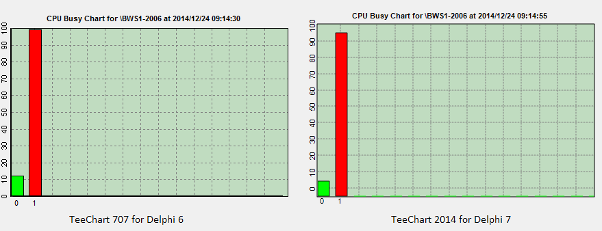

I am converting a program from WinXP/Delphi6/TeeChart v707 to Win7/Delphi7/TeeChart v2014.
The above attachment shows the different results.
Both charts have the same values (green is 12 and red is 99)
The TeeChart 707 for Delphi 6 correctly shows the Y value 0 at the base of the chart and the green value is at 12 red at 99
The TeeChart 2014 for Delphi 7 INCORRECTLY shows the Y value 0 up at approximately value 5 and the Green value seems to be about 5.
I cannot seem to find the chart setting to change the Y Axis to set 0 at the bottom of the chart and have the chart appear like the older version.
Any help would be appreciated

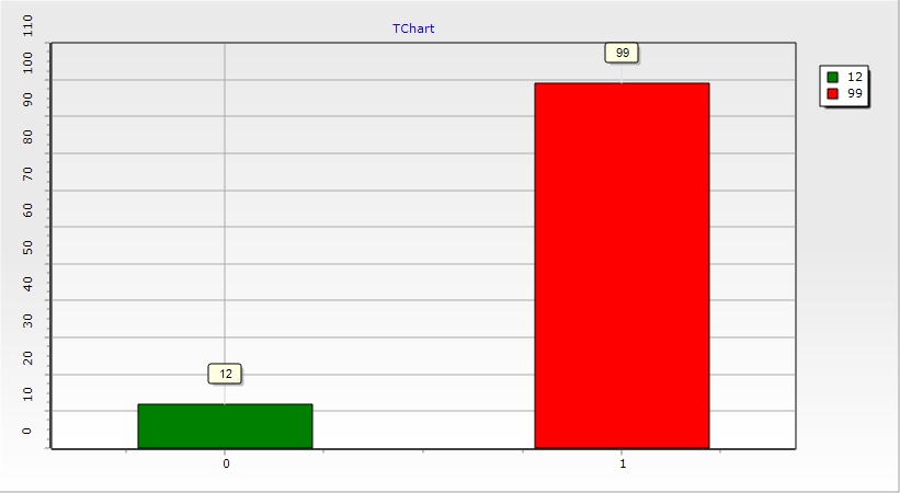

Using this code with v2014:
uses Series;
  Chart1.View3D:=False;
  Chart1.AddSeries(TBarSeries.Create(Self));
  Chart1[0].Add(12, '', clGreen);
  Chart1[0].Add(99, '', clRed);
I get this chart:
which is correct, just as your v7 chart. Does this code work fine at your end? Can you please attach a simple example project we can run "as-is" to reproduce the problem here?

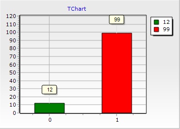

Thanks for the information. However, code below works fine for me here.
uses Series;
  Chart1.View3D := False;
  Chart1.Axes.Left.LabelsAngle := 90;
As you can see in this image:
Does this work fine for you? Can you please attach a simple example project we can run "as-is" to reproduce the problem here?

I don't think you understand the problem.
On the chart you created look at the green bar, its value is 12 but if you look at the number it aligns with on the left axis labels it is more like 6.
The axis grid lines are correct but the axis labels are not aligned with the axis grid lines
Re: Converting from v707 to v2014
Post by Narcís » Tue Dec 30, 2014 3:12 pm
Thanks for the feedback.
Ok, I understand it now and added the defect (ID1067) to bugzilla. A workaround is setting the labels to 89º, e.g.:
  Chart1.Axes.Left.LabelsAngle := 89;
