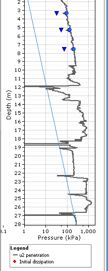

I am having problem with a legend not displaying correctly all the items, please find attached a test project. If you run the project and resize the form horizontally you will see that some times all the items appear or hide...
Also in my actual application there is a glitch that the test application cannot reproduce so I included a screenshot, at some point (while resizing horizontally) an axis label appears on the far left of the plot, it appears to be a bottom axis label.
I am using the latest 2015 TChart version under Delphi XE7.
