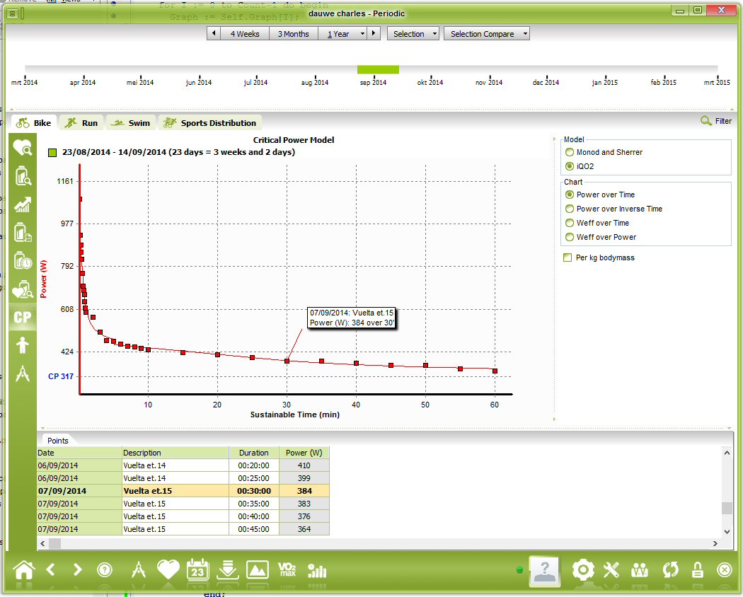

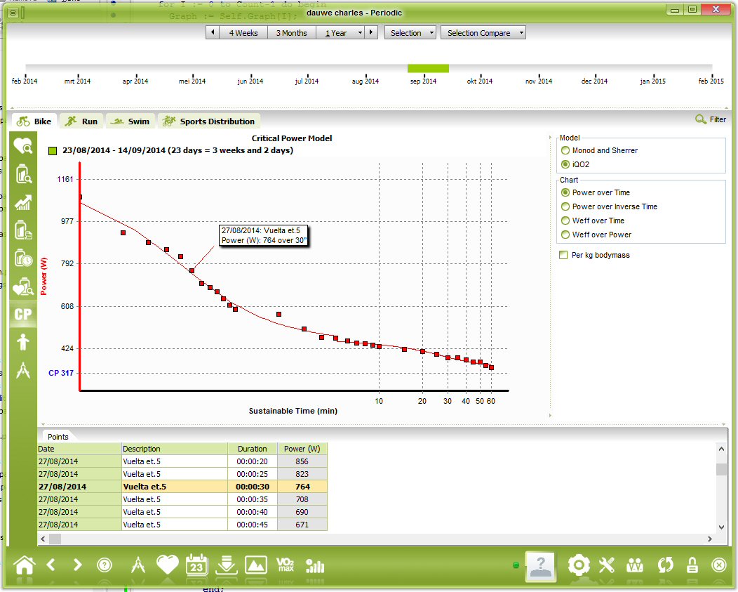

I have attached two screenshots
1st is the graph in non-logarithmic mode where the x-axis is divided into 10' increments
2nd is logarithmic mode, also divided in 10' increments
I set the bottom axis min/max values myself = 5/60 .. 60, or from 5" to 60'
The problem I have is that changing the LogarithmicBase property does not change anything how the bottom axis is scaled. Set it to 2 or 100, no difference.
I would like to scale it so the first 10 minutes is less spread out.

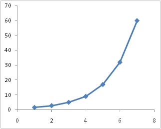

The post entry starts with this:

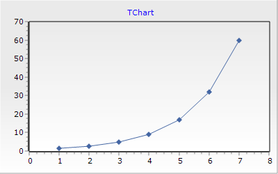

Here’s the data in a default XY chart.
And here it is what I get if I load the data above in a TLineSeries with the default axes (I just change the min and max and some minor setting for aesthetics):
uses Series;
  Chart1.View3D:=false;
  Chart1.Legend.Visible:=false;
  with Chart1.AddSeries(TLineSeries) as TLineSeries do
    Pointer.Visible:=true;
    Pointer.Pen.Visible:=false;
    Pointer.Style:=psDiamond;
    AddXY(1, 1.5);
    AddXY(2, 2.75);
    AddXY(3, 5);
    AddXY(4, 9);
    AddXY(5, 17);
    AddXY(6, 32);
    AddXY(7, 60);
  Chart1.Axes.Bottom.Grid.Visible:=false;
  Chart1.Axes.Bottom.SetMinMax(0, 8);
  Chart1.Axes.Left.Grid.Visible:=false;
  Chart1.Axes.Left.SetMinMax(0, 70);

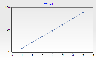

Here’s the data with the default base-10 log axis scale.
And this is what I get if I set the left axis to be logarithmic
uses Series;
    AddXY(1, 1.5);
    AddXY(2, 2.75);
    AddXY(3, 5);
    AddXY(4, 9);
    AddXY(5, 17);
    AddXY(6, 32);
    AddXY(7, 60);
  Chart1.Axes.Left.Logarithmic:=true;
  Chart1.Axes.Left.SetMinMax(0, 100);

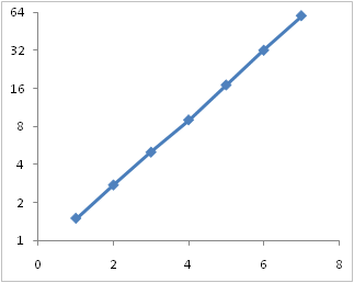

The article ends with this:
Here is the chart with a base 2 log axis scale.

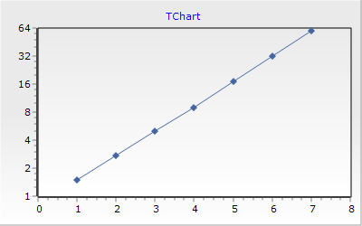

And this is what I get if I change to log base 2:
uses Series;
    AddXY(1, 1.5);
    AddXY(2, 2.75);
    AddXY(3, 5);
    AddXY(4, 9);
    AddXY(5, 17);
    AddXY(6, 32);
    AddXY(7, 60);
  Chart1.Axes.Left.LogarithmicBase:=2;
  Chart1.Axes.Left.SetMinMax(1, 64);
