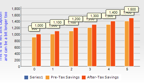

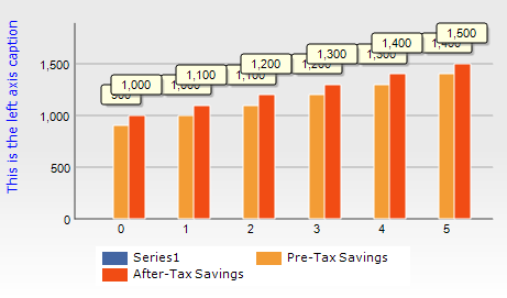

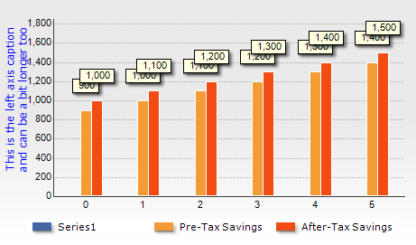

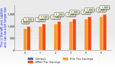

This is what I see when running your project here with the latest version: And this is how it looks if I run it with TeeChart v8, activating GDIPlus to better compare:
I'd suggest you to implement some anti-overlapping system. I actually see I already suggested it to you. Have you tried it?
Did you see this not happening in any specific TeeChart version?TestAlways wrote:1) Marks overlap
