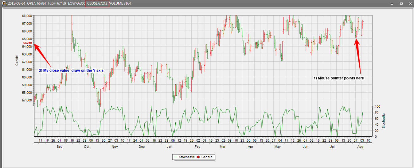

I am trying to draw my closing value from by candle stick on the Y axis, but with no luck I am getting it right.
I am trying to accomplish the following.
1) By default when my chart is loaded I want to highlight on the Y axis the highest closing value in different color.
2) Secondly if possible can I draw also on the y axis the current closing value if the mouse move over a series.
I already have the closing value on mouse move.
Here is a screen shot with my idea.
I hope this can help.

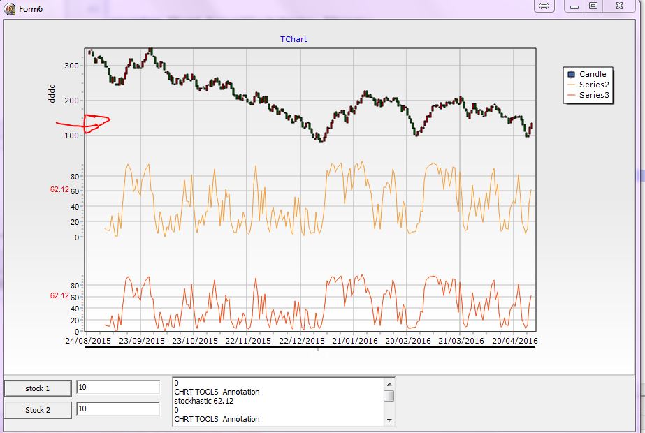

Sorry to keep coming back to this, but I am starting to completely loose it with myself. my problem is as follows :
I dynamically create a new function each time and a TAnnotationTool. I am trying on my SetAnnotationPosition to set each closing value to each custom axis created, but this is were I am completely loosing the plot.
I have tried all different ways but cant get it right. Can you please see if you can determine if this is possible.

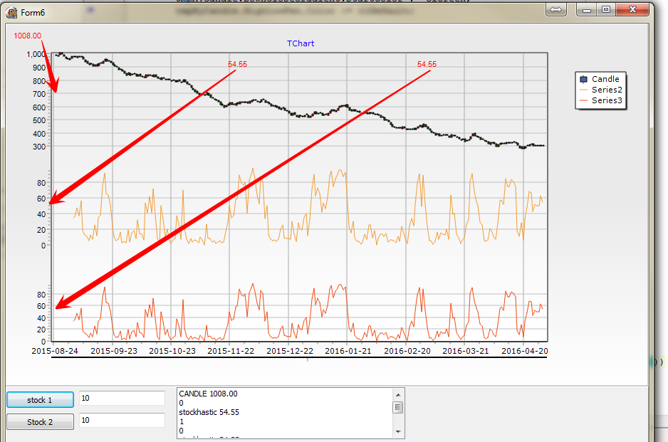

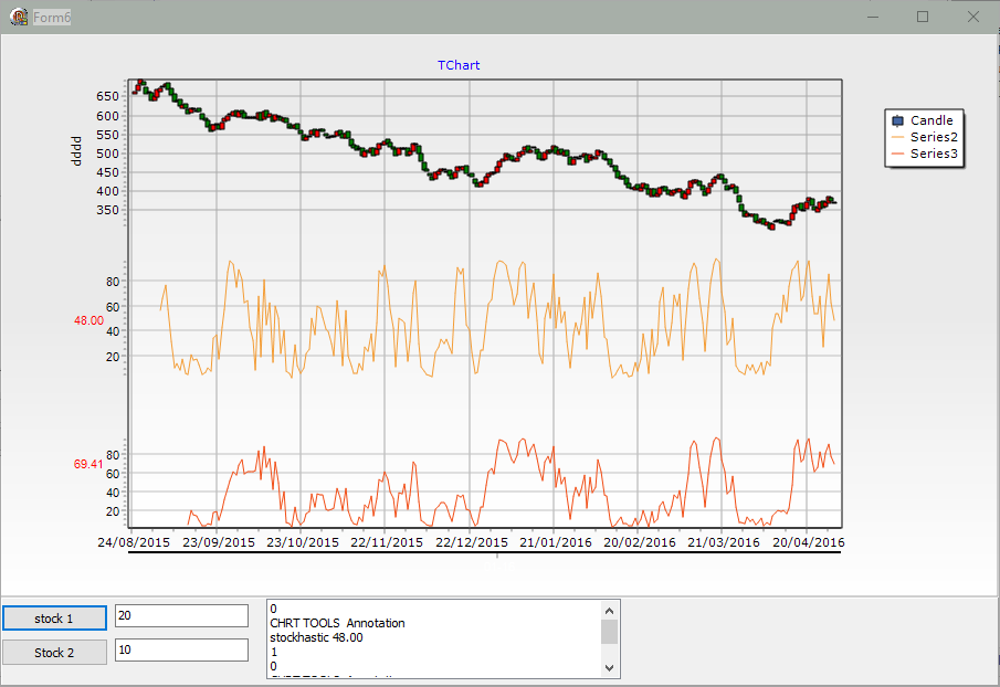

Post by Yeray » Tue Aug 25, 2015 3:39 pm
First of all note you start creating a TCandleSeries with a CustomAxis assigned to it. This is fine if you want but later you are trying to synchronize tools with custom axes and this would be cleaner if you have as many custom axes as annotation tools. So I start removing the initial custom axis assigned to the TCandleSeries.
I also removed the SetAnnotationPosition method and I'm recalculating the positions of the annotations at the calculateaxis. I'm doing this way because the new positions of the axes should also alter the positions of all the annotations.
Here how it looks:
And the project modified:
chart dynamic.zip
(2.93 KiB) Downloaded 1046 times

Take a look at it:
chart dynamic.zip
(3.22 KiB) Downloaded 1048 times
