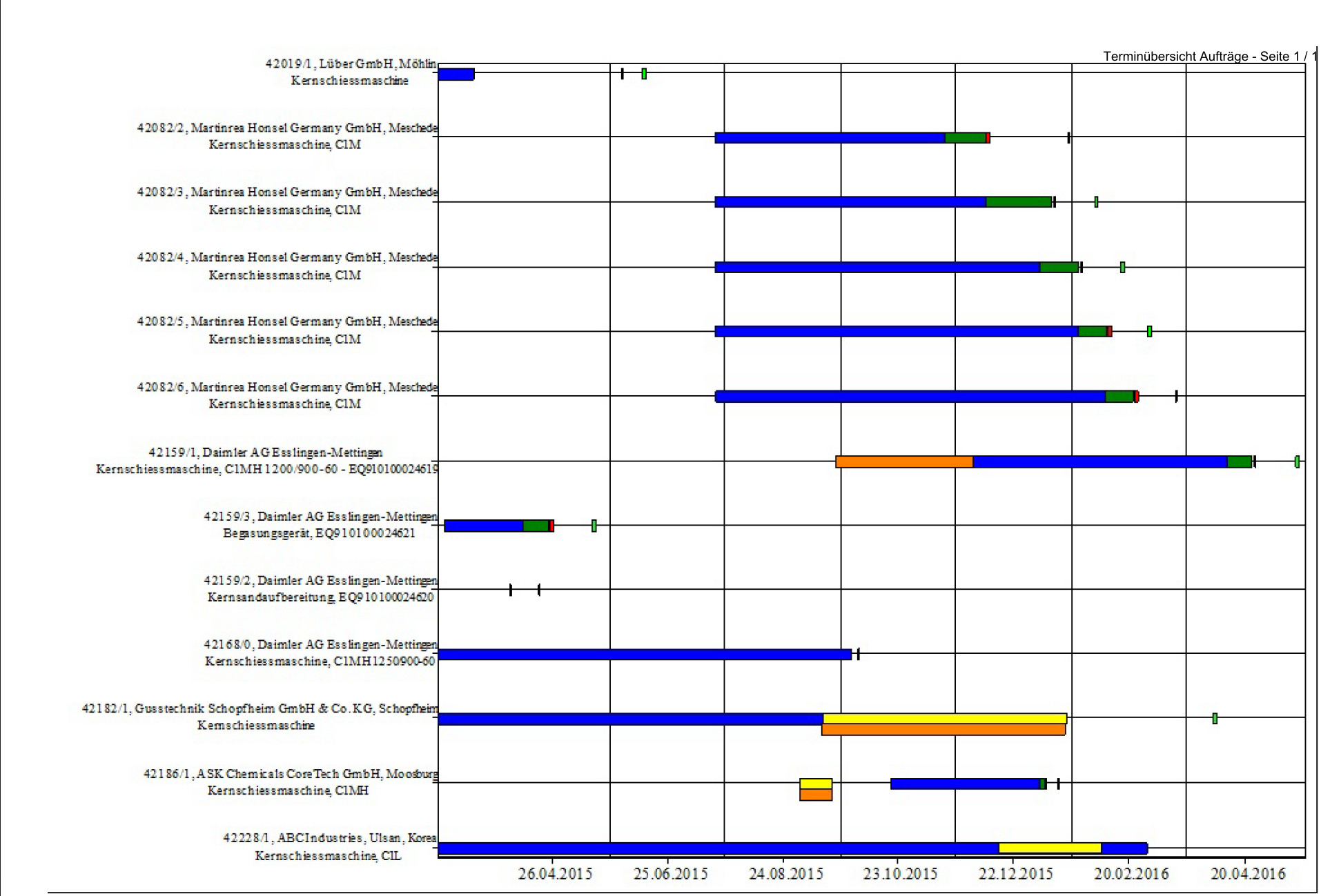

I have attached a PDF, that shows the acutal print out of my gant graphic.
The bottom axis shows the date of the gant data. I try to show also the top axis with the week number of the year, assigned to the gant data. But i don't have any idea where i have to start with programming.
Also does i have the problem, that the text are not realy clear (pixels) at the print out and the allignment are should be left!
May somebody have my a hint.

viper wrote:The bottom axis shows the date of the gant data. I try to show also the top axis with the week number of the year, assigned to the gant data. But i don't have any idea where i have to start with programming.
You should assign both axes to your series to make them visible.
Series1.HorizAxis:=aBothHorizAxis;
Since there's no formatdatetime to show the week number of the year, you should use OnGetAxisLabel event to format the string manually. Ie:
uses DateUtils;
  Chart1.Axes.Top.Increment:=DateTimeStep[dtOneWeek];
  Chart1.OnGetAxisLabel:=Chart1GetAxisLabel;

viper wrote:Also does i have the problem, that the text are not realy clear (pixels) at the print out and the allignment are should be left!
We should differentiate:
- Printing resolution. Take a look at the printing better article here.
- Alignment. I'm not sure to understand what doesn't look as you'd expect. Could you please expand? Note an sscce helps to easily understand and reproduce the problems.

Thank you for your fast respons and answer. I could solve my problem with the calendar number and printout resolution.
Now it just left the problem with the alligment of the text (Gant) at the left side.
When you take a look at my printout example, the text for the gant are center alligned. But i try to allign it left, but i can't find the responsible property.

viper wrote:Now it just left the problem with the alligment of the text (Gant) at the left side.
Try with this:
Chart1.Axes.Left.Items.Format.TextAlignment:=taLeftJustify;

Thanks, you Tip works perfect.
