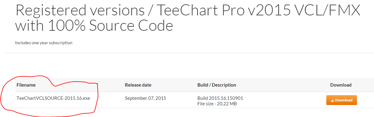

I upgraded to TeeChart Pro v2012/15 VCL with sources to support Delphi 10.

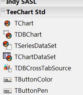

But after installation I'm missing components that I use in my project. TchartEditor and many more.
It looks like it is the TeChart Standard instead of Pro.
I downloaded this version from your site.

It looks like that after I did a recompile with the TeeRecompile tool, the components from the Pro version showed up

Yes, you have to run TeeRecompile to compile and install the components.
