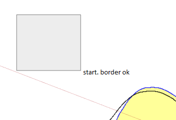

2) Colorbandtool border not displayed if created from left top to right bottom ? How can i fix this to have this border displayed correctly for all situation ?

Is that a Colorbandtool?

No soory, it's a TRectangleTool. I will try to give you a simple project soon. Thanks

Hello. I have added a simple project to illustrate my problem (Test_project.zip)
It's a TRectangleTool.
Can you have a look please ?

I see the tool's Hover feature is interfering here. If you disable it (ie, at FormCreate) the border is drawn again:
  ChartTool2.Selected.Hover.Visible:=false;

That work, thanks
